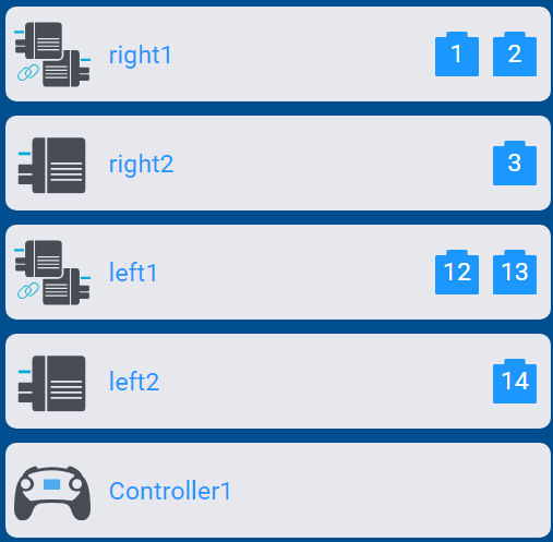

Can you have a 6 motor drive? If you can, how do you program it on the motors section on vex 5 blocks. Because their is only 2 drivetrain or 4 drive train?
You can have as many motors in a drive as you want. To program it you need to control each motor individually rather than with the default drivetrain blocks.

this is how to set up the devices
Actually, the spin blocks don’t need to be in the loop. Because the motors are told to spin in accordance to the stick value, they never stop. This means you don’t need to tell them to spin, because they are already spinning regardless of their velocity.
