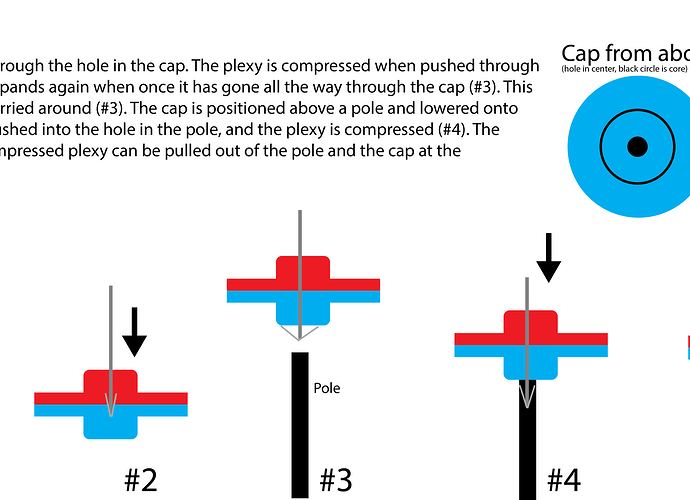

I made a picture of a passive claw type of thing. I think people used this idea in Sky Rise, but I’m not sure. I haven’t tested this so I don’t know if it actually works, but in theory it should.
