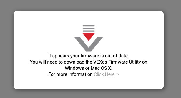

The web version of VEXcode IQ will still tell you that your IQ Brain needs an update if it is out of date. However, it will still let you download projects to the brain even when it is out of date. You will need to click out of the update message to continue to use VEXcode IQ, but it will still work.
Are you just seeing the update message (below) or are you trying to download a project?
If you are trying to download a project and the download button is disabled, please try the following.
  1. Make sure that the version displayed in the about screen (File → About), is 3.0.1-10. If you see a different version, there is probably a caching issue and we will need to clear the cached version so that you can access the current version.
  2. Refresh the VEXcode page and reconnect to the brain. There is an issue where VEXcode can think that the brain can not have any data sent to it. Restarting the app (page refresh in this case) fixes this.
  3. Try restarting the browser. Since all the communications with the hardware for all the web versions of VEXcode are passed through the browser. So if there is an issue with the browser, a restart of the browser is a good first step to fix this.
If you are trying to download a project to your out of date IQ Brain and it is not letting you, can you please submit feedback after the download fails? Please make sure the diagnostic data is included and reference this thread post so that I’ll now it is from you. This will let me see what VEXcode is doing that would prevent you from downloading.

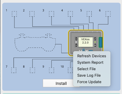

For right now, we can try to pull the firmware update directly and load it on your VEX IQ Brain. Since this firmware also updates the motors, I would recommend that you have all your motors connected to the IQ Brian before you start the update so that they can all get updated with one pass. Otherwise, you will need to repeat the process to update the motors later.
Update steps
  1. Download the firmware file directly from https://content.vexrobotics.com/vexos/public/IQ/VEXOS_IQ_2_2_1_0.vexos
  2. Open the VEXos Utility (make sure VEXcode is closed)
  3. In the VEXos Utility, right click on the brain icon and select “Select File” (your interface might be slightly different but the Select File option is the same)
  4. Click the “…” button and select the downloaded .vexos file
  5. Install the update on your IQ Brain by clicking the Install button.
Thank you that worked!
