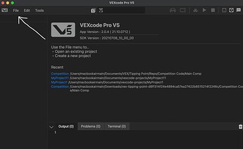

how to get there

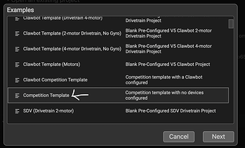

File ->open examples-> find competition template after the clawbot one (7th one down)->open it
Go to VEXcode Pro V5, press “File”.
Then click “Open Examples”.
Lastly, scroll down and click the seventh option called “Competition Template”. If you are using a Clawbot, click “Clawbot Competition Template” instead.
