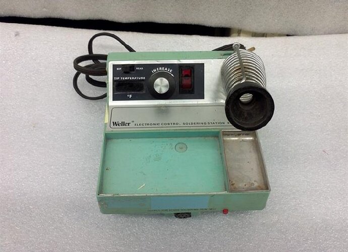

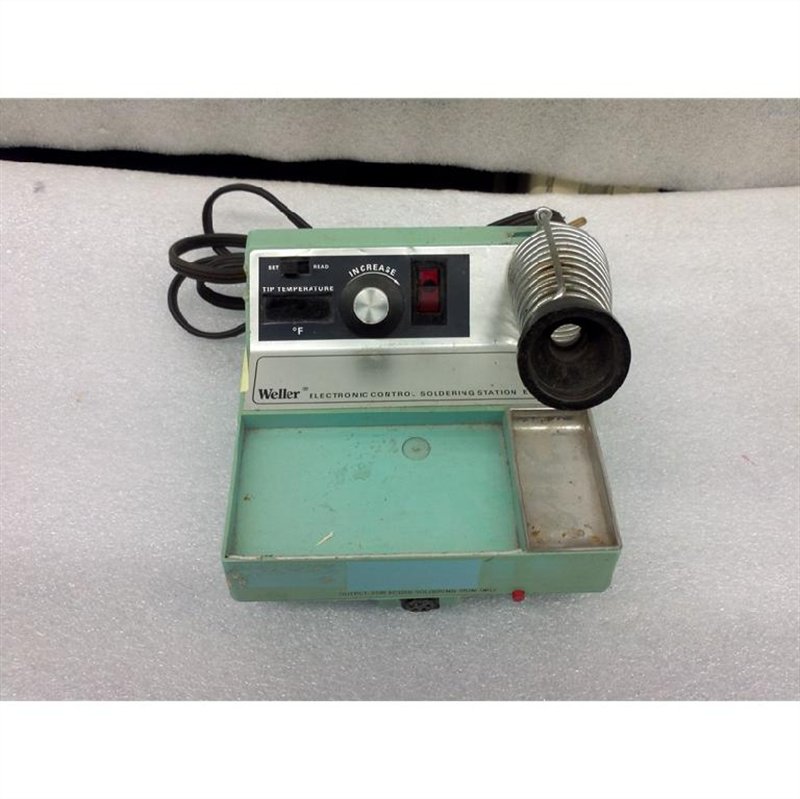

My old Soldering Station is a Weller EC-2000, that needs the Plug in the Base fixed before it will work again.
Temperature Controlled and a Good Tip, are mandatory for Good Results…
A classic, used that one many times in the last century.
I don’t do this type of work that often but when I do this is what I use.
