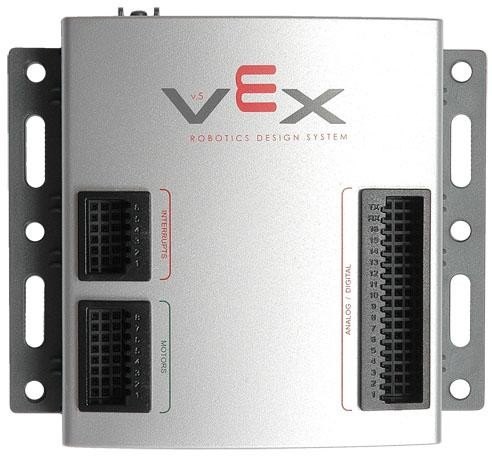

So I still have this lying around, which is what was shown as the 2nd generation on the V5 teaser at Starstruck Worlds. It’s about the same size as the PIC/Cortex, compared to the FRC controllers. We got it with our FRC kit in 2005.
20190418_214538
The PIC 0.5 was the first Microcontroller used at the FVC inaugural competition in April 2005. FVC was initially announced as FRV (FIRST Robotics Vex), but changed to FVC during the 1-month build period. Durign the development phase (before the first competition), the program under FIRST was called “Robovation”, but Vex quickly made its way into the name. tourney1
