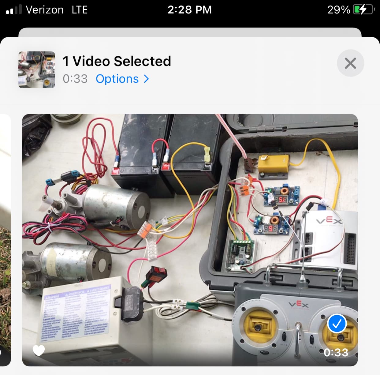

Thanks for your help and explanation. I’ll go back thru the information again. BTW here is a pic of my project. Remote controlled tractor.
On the tractor moving the forward/reverse travel pedal. Another motor controls the steering. Right now I’m using the stock 23 mode. Channel 2 is steering, channel 3 if travel. I’d like to program the system using one joystick for steering and travel. Possibly the switches to control the 3 pt hitch etc
what we call arcade control
I believe the default code supported that if jumpers were installed correctly.
check page 7-4 of the old inventors guide, a copy here.
alternatively you could easily program that in RobotC, you will need programing cable etc. to be able to download onto the PIC. It’s been years since most forum members used the PIC, it’s a very old system, I have no idea what will work on a modern PC.
