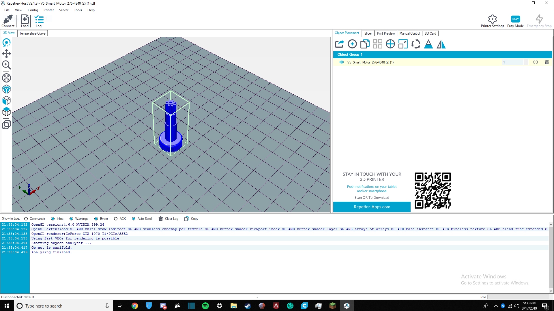

I tried this a second ago. For some reason it only converts the internal gearing? It is very odd.

repitier host, thinkercad, and cura.
this is what it looks like
I would help more, but I am not familiar with that software.
Although, could you upload the file as an STEP, then export it to an STL?
