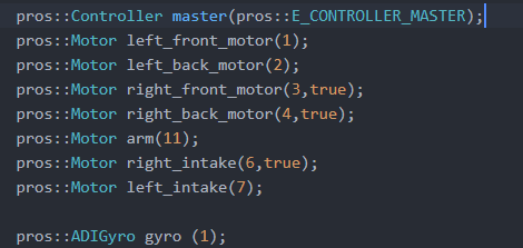

I am trying to create global variables for my code. I don’t know what to put in. These are my variables.
Pros%20Code
What exactly is your question? It is not clear from what you posted.
I want to know the steps in creating a file for global variables.
I’m not sure those are variables

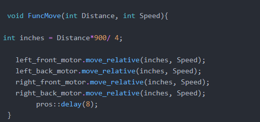

Oh, sorry for misunderstanding, then how do I create a function outside of autonomous.cpp as an example, and then call on it in my autonomous.cpp. This is my function as an example↓ ↓ ↓ ↓
Function
You need to make a header file for it. You put soley the function header of the function you want to declare globally in that header file and #include that header file in the main.h file (towards the bottom there is a section for global header files).
Edit: make sure you #include the main.h file in all of your files. The function header would be void FuncMove(int Distance, int Speed);.
Set it up out of other functions
You need to put everything you want to be global into an .hpp file. Use the extern keyword for variables and objects (things like pros::Motor). Remember only to declare the motors and variables within the .hpp file as otherwise it gets messy. Do the definition within a separate .cpp file.

For functions, its pretty similar. You just don’t need to use the extern keyword for functions (still keep the definition out, you only want a declaration). An example .hpp and .cpp file like the ones above for an autonomous movement function.
The .hpp file
//can be replaced with #pragma once, is an inconsistency but doesn't really matter. If you use ifndef make sure the name is different for each file.
#ifndef DRIVE_FUNCS
#define DRIVE_FUNCS
//moveAbsDir returns nothing and takes three parameters
void moveAbsDir(double leftX, double leftY, double rightX);
//moveAbsUser returns nothing and takes no parameters
void moveAbsUser();
//moveAbsTo returns a boolean when finished and takes 3 variables
bool moveAbsTo(double x, double y, double z);
#endif
The .cpp file for moveAbsTo (moveAbsUser and moveAbsDir are in a separate .cpp files from moveAbsTo).
#include "main.h"
bool moveAbsTo(double x  = NAN, double y = NAN, double z = NAN){
  //blah blah blah math math math call other function blah.
  //insert your code for function and movement here or something
  return true;
And then in the above example included the “drive_funcs.hpp” into “main.h”. Same principle as with including “motors_setup.hpp” into “main.h”. After that you can use that function anywhere in the program where “main.h” is included.
