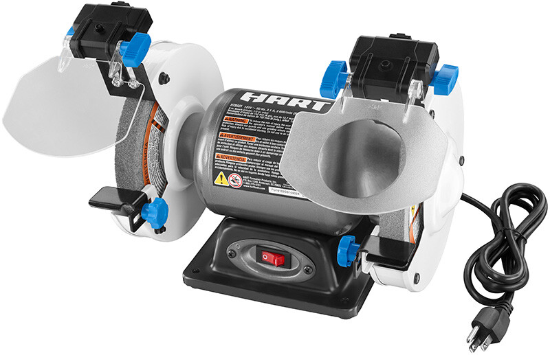

Could you please share what tools you find most useful for grinding/filing after cutting steel shaft and aluminum bars?

Generally a grinder (bench, or rotary mounted to a dremel), and a file are what I use to grind and file metal.
Dremel is great tool for both cutting and grinding, small, multipurpose, and portable. As for the type of bit for the grinder, I would suggest using metal ones, the grinding stones for me at least tend to have metal/plastic stick to it and it becomes useless

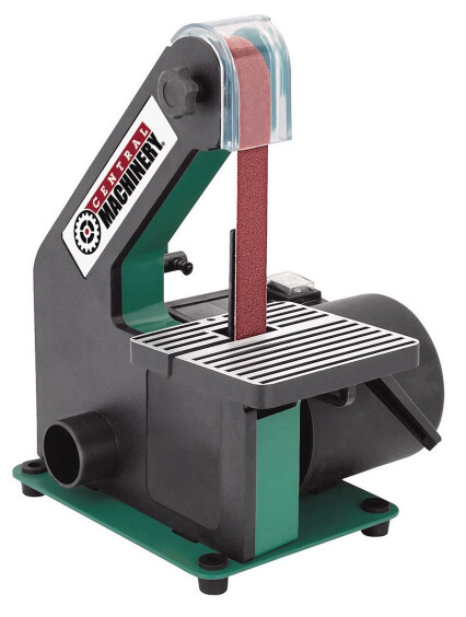

For hand tools, we keep several files around. For power, this little HF grinder is cheap and functional: https://www.harborfreight.com/1-in-x-30-in-belt-sander-61728.html

We use two belt sanders like this for most things.
