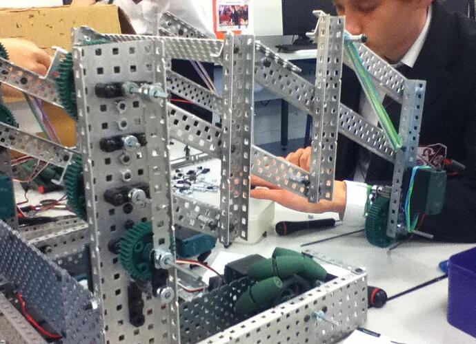

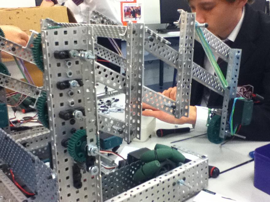

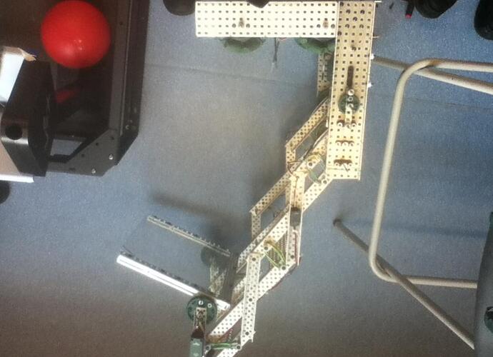

Really do you have any pictures of your lift.

Yes here they are. We are rather short of parts at the moment so unless there is an eays fix we may have to leave it as it is.
[ATTACH]6940[/ATTACH]
[ATTACH]6941[/ATTACH]
[ATTACH]6942[/ATTACH]
When the arm is all the way down what does it rest on?
The large high stregth gear is touching the floor as is the tray. Is that what you mean?
If the intake wasn’t attached it looks like that arm could still go down farther and that would allow for a longer arm to still be in spec and the intake to be remounted higher up. If you don’t have the metal to make a longer arm you could just moved the bar the intake is attached to up a hole and lowered the arm more when you intake.
