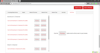

If you go to the bottom of any product page for a product on the vexrobotics.com website, you will see a function to download the part (as a .STEP file, which can be converted to .ipt, .iam, whatever)
(I’m probably doxxing myself in this screenshot and I don’t even know)
