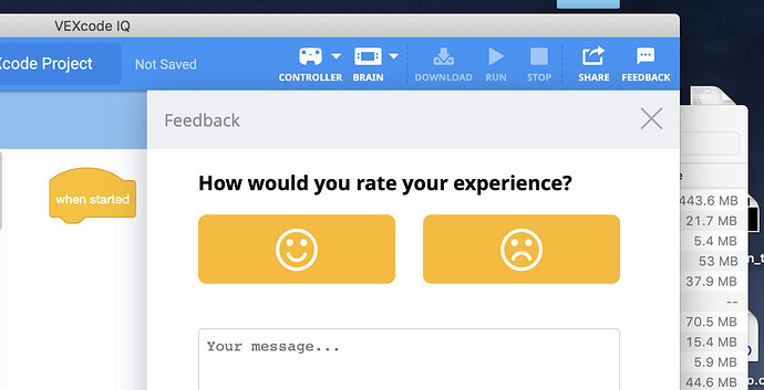

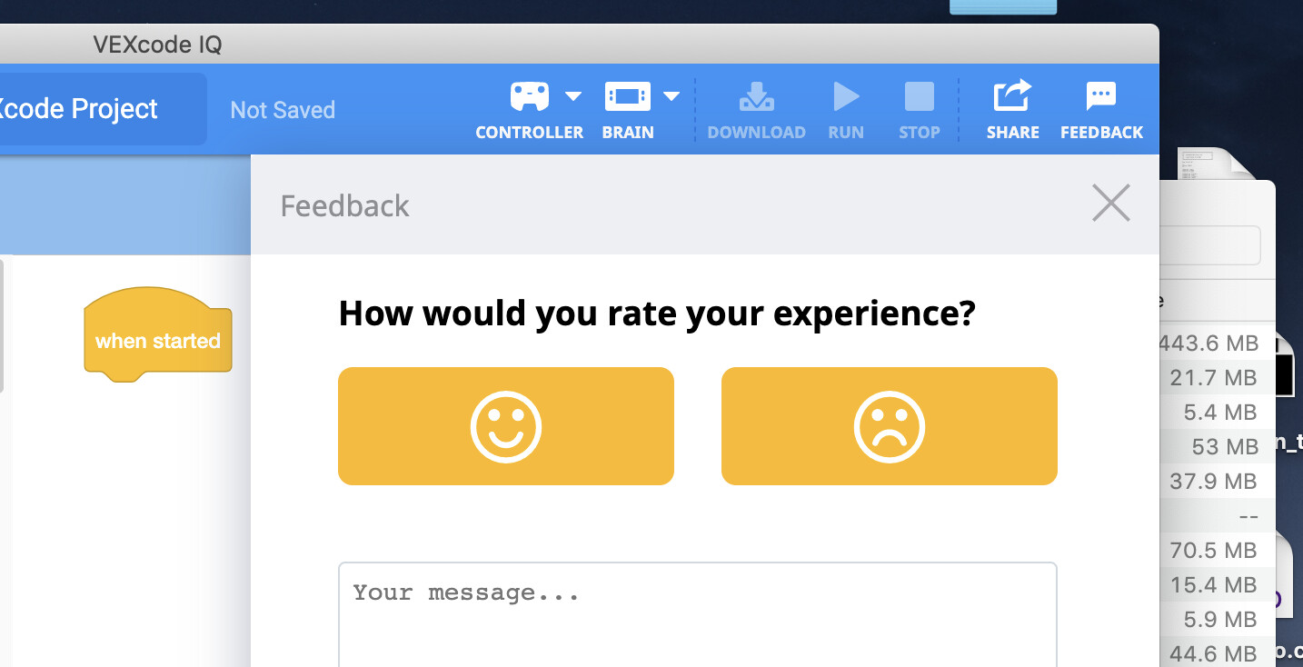

Kay, thanks! How do we contact vex support or use feedback after failing to update?
sigh,
and the feedback button
We looked at the logs in feedback and it’s not giving any useful information beyond indicating that a firmware update starts and the brain then disconnects a couple of minutes later.
