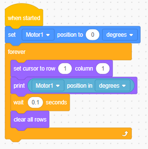

Somewhat related - we were trying to get the brain to display the current position of the arm in degrees. It’s a 1:9 reduction; about a 120* throw, so we were expecting something around 1,000 degrees.
The printout was 000.000.000.000.000 to 000.000.000.000.006.
We tested both degrees and turns; we never got any results from turns.
Any ideas?
Could you post your code? Something like this should work:
Ah the wait - clear all rows combo makes sense. Thanks!

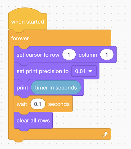

I am using a Mac & OS Mojave. I tried many different sets of code but here is an example of a simple timer that also throws out the ‘Fatal Error Detected’ ‘Error Code 4’ and requires a reboot of the brain.
37
Tried that code and it worked for me without issue.
Have you updated the brain to the latest vexos which is 2.1.3 ?
Yes I have updated the brain to 2.1.3 and all the sensors as well.
Still giving me the same error.

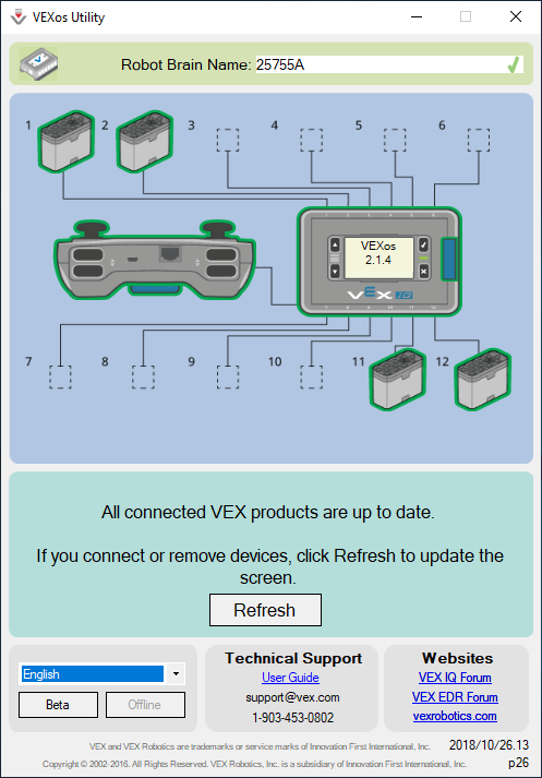

After we updated the firmware this weekend our teams robot started to have the same error “fatal error code 4”. The error message is coming up when we hit to run the program, and happens only on programs that include the controller. It happens every time the run button is hit from the computer and occasionally when the program is started from the brain.
That’s a known bug in VEXcode, update the IQ to the latest vexos to solve.
We are on version 2.1.4. Is there something else we need to be doing to fix the issue?
This issue should be resolved with using VEXos 2.1.4 and VEX IQ Blocks 1.0.8, which was released on Dec 20th.
