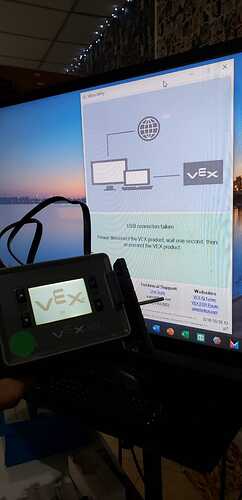

I’m through some difficulty with the IQ brain
As soon as I turn on the Brain it gets stuck on the screen shown in the image.
I connected the brain to the computer and also started the VEXos even though there is a failure to communicate with the USB port and the software can not read the Brain.
Someone tells me the best action to solve this problem!

Try powering on with up and down arrows held down, see if the vexos utility can talk to the brain in DFU mode.

Thank you!
That solved my problem!
