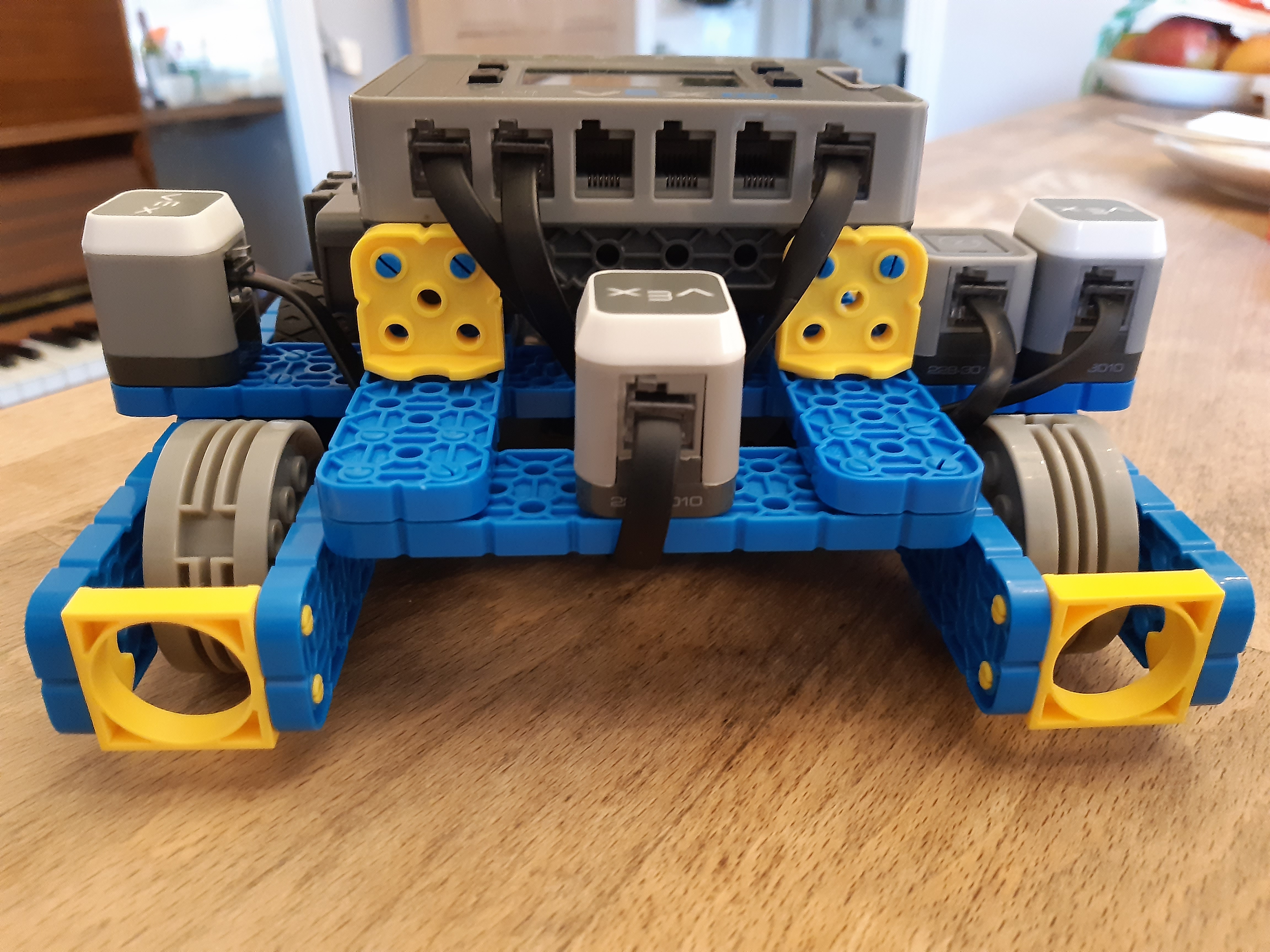

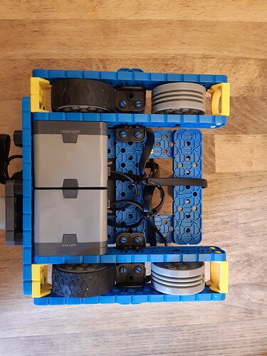

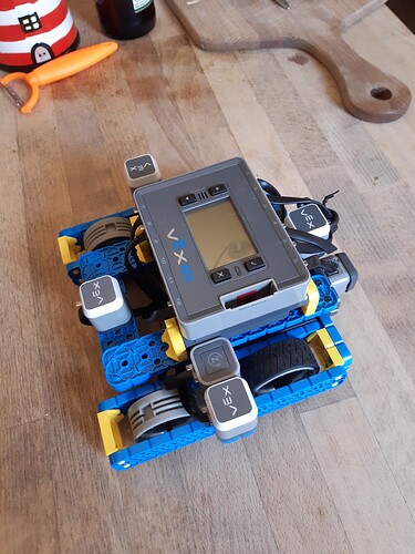

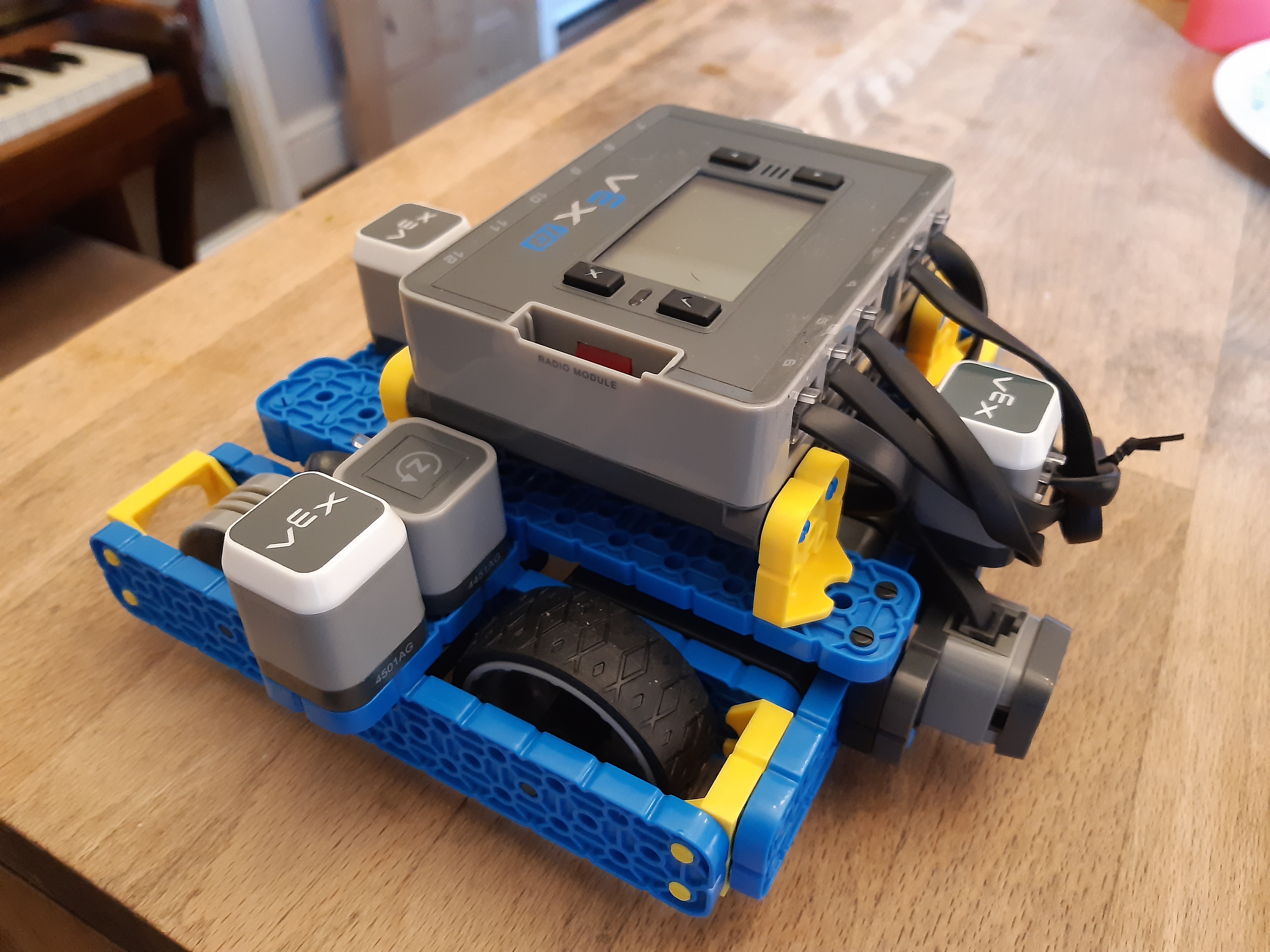

I created a little floorbot using IQ and programmed in VEXcode IQ Blocks. Works on the same principle as 123 by “programming” steps using the forward, backwards, left and right buttons. It has a 100 step memory.
Great to keep my 4 year old occupied for a bit.

The build uses plastic shafts but need to replace these with metal as there is too much bounce in the plastic ones to be ideal.
