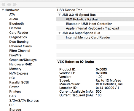

Folks, I’m using the VEXOS utility but it will not recognize the VEX IQ Brain. What I have tried already:
I have downloaded the latest version of the utility.
I have tried three different cables in hopes it was the problem.
I have tried one PC and two Macs.
I have tried every possible USB port.
Still every time the utility will open fine but it cannot see a device connected. I typically turn the brain on after connecting the device to a PC/Mac.

In Windows Device Manager, do you see two active VEX devices under Ports(COM&LPT)?
I don’t see anything in the Device Manager (Ports / COM & LPT) that relates to VEX…

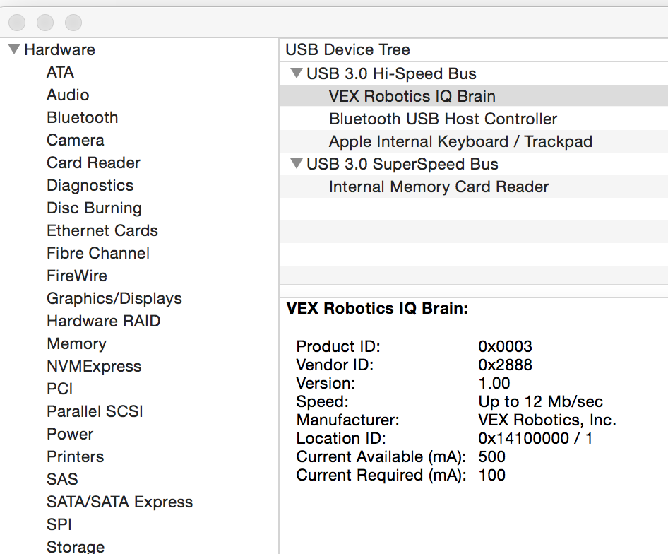

On a Mac you can verify the brain is recognized by checking system information and selecting USB
you should see something like this.

If none of that shows up then VEXos utility will not be able to connect to the brain as the PC/Mac is not detecting the hardware.

Yes, the PC/Macs are not detecting the brain…that is my core issue to resolve.
based on everything you have told us, it seems the IQ brain USB is defective, not much more we can do.
