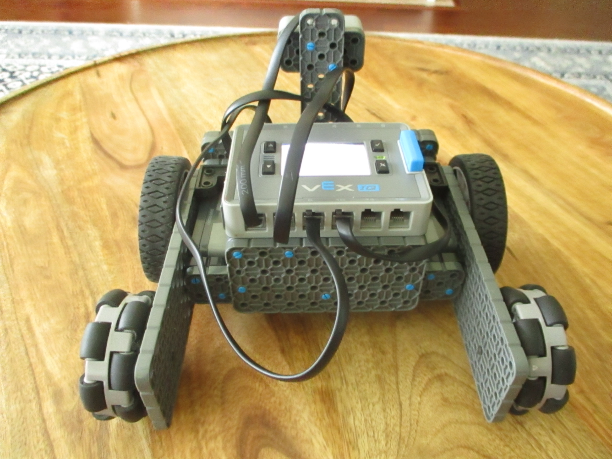

This is my vex iq house rover. It simply explores your house by going forward until it is close to a wall. Then it turns in a random direction and starts going again. Even though there is one problem, i can’t figure out ho to make it randomly choose to turn left or right so i just have it turning right for now. So i was wandering if ya’ll could help me out.
I can probably help, but I can’t help at all if you don’t post pictures of your robot and a picture of your robot code. This sounds like a great project!
To post a picture of your robot, press the Upload button when making your post. To post a picture of your code, do the same thing, to post your actual exact code, click the Preformatted Text or Control+Shift+C when making your post and then paste your code into the box.

How are you programming this robot? (RobotC, VEXcode IQ Blocks, RobotMesh)
What language are you coding in?
I’m using robotc.

rand() % 2 will evaluate to a random integer, either 0 or 1.
You can branch based on the result of this call like so:
if (rand() % 2){
    //this code will run if the random number generated is 1
else {
    //this code will run if the random number generated is 0
Note that if (rand() % 2) works in this case because integers evaluate to false if 0, and true otherwise. If you want more than 2 options, rand() % n will generate a random int from 0 to n-1 inclusive, and you can branch based on the result of that with a switch or a bunch of else ifs.
Thanks a lot. It works perfectly. Here’s the new code:
