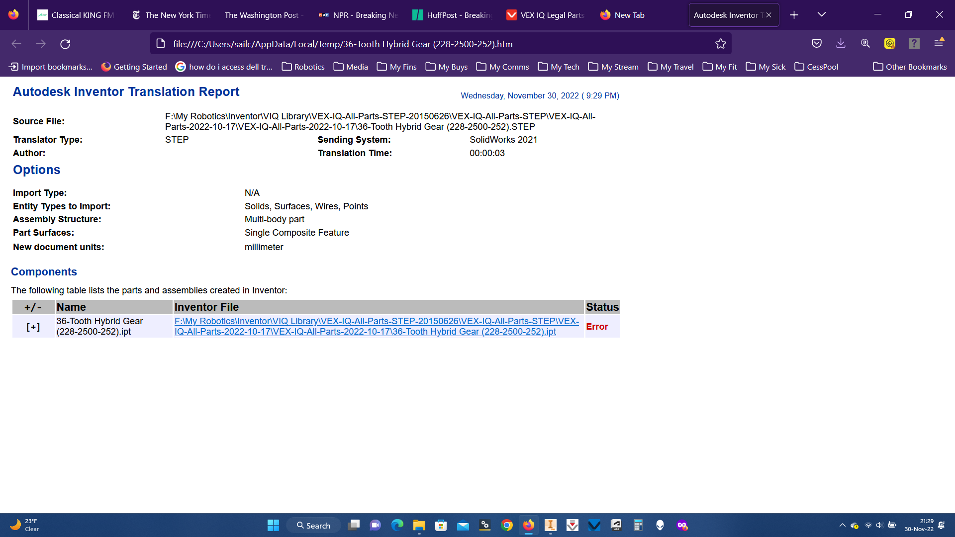

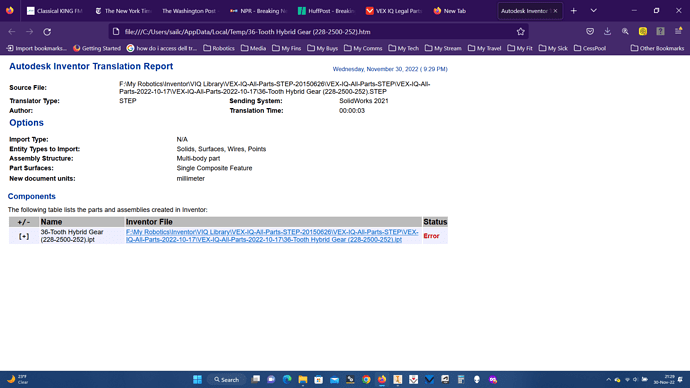

The 36-Tooth Hybrid Gear STEP file has errors. See screen shot below.
I think I got it patched up. It is saved as a simpler format of STEP file. Let me know how it works for you.
36 Tooth Hybrid Gear (228-2500-252).STEP (8.4 MB)
Yes that worked.
Thanks.
