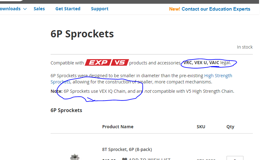

V5RC 6p sprockets use the same chain as VIQ sprockets, but just have a HS hole. When they’re referring to IQ sprockets, they’re most likely referring to V5 6P sprockets, which are legal.
If they are using the IQ sprockets themselves (and not just the chain), that is illegal.
