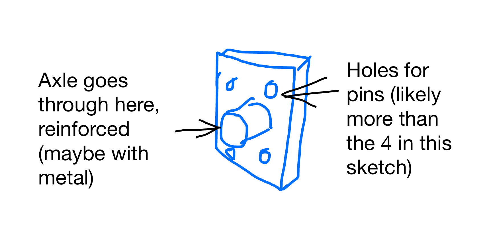

As far as I know, bearings (like the ones in V5) don’t exist for IQ. A similar part for IQ would save so many of the plastic holes from warping. The part would ideally be a bit tougher than the regular IQ plastic (maybe reinforced with metal?).
This also will help reduce friction from the not-circle holes which should improve autonomous skills consistiency since we do not have shaft encoders (please Vex!)
For high stress loads you can double the beam up with a 1x3 or larger. The other thing is to not have cantilevered gears/wheels. I’m seeing pictures of flywheel shooters that could really benefit from having an end support.
You are right that the plastic beams can be doubled up, but the holes of the outermost plastic beams still get bent when the beams are doubled up, especially if there is a lot of force (other than just rotation) acting on the axle. Bearings like the ones in V5 would help with distributing the force to a larger portion of the beam than just a single hole. For this purpose, the bearing would have a larger attachment surface than the V5 ones, possibly a 3x3. Concept sketch/diagram:
So you want these High Strength Shaft Ball Bearing (11-Pack) - VEX Robotics with a 1/8" insert rather than the 1/4" insert. Those bearings are VIQ sized, you would just use a 0-2x pin.
But that doesn’t help your beam twist issue as you noted. You would need to switch to doubled up 3x beams / plates.
Nice drawing!
Not quite, I was trying to explain a part like this:
but with a circular hole, meaning the force from the axle would be spread between 4 holes instead of being applied to just one. The axle would also have to be able to go all the way through the part, unlike with ball bearings, to allow for the part to be used in drivetrains (attaching the drive axle). This would help with preventing the holes of the plastic plates from being chewed up by metal axles (couldn’t find an image).
