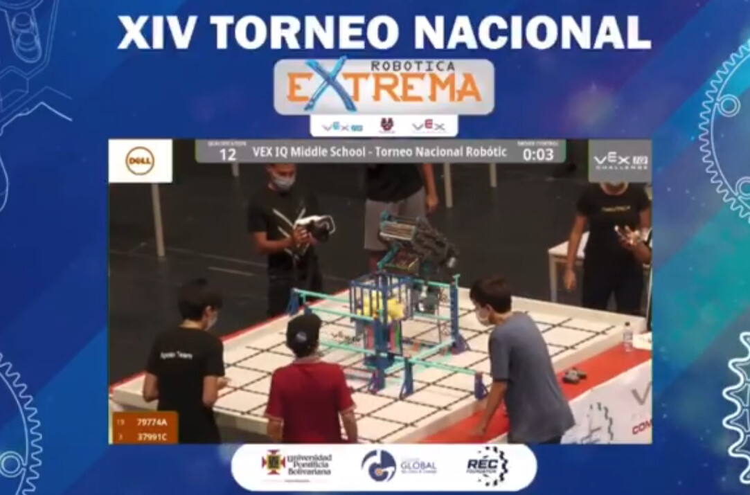

Hi Holbrook, this week in the Latin American championship in Medellin Colombia happened a similar case, the winning robot of the competition took all the balls at the time to the goal, but the organizers @FunGlobalACT did not see any violation of the rule.
I leave one of the videos where you can see how it works Emisión en directo de Fundacion Global AC&T - YouTube
![sc_1|690x391]
What do you think about this?
Looks like a clear violation to me – either of G19 if there is no part of the robot contacting the floor:
Or if there’s an appendage reaching down to touch the floor (it’s a little hard to tell from the video whether or not that’s the case), then the robot is clearly way taller than 19 inches which would violate G5b:

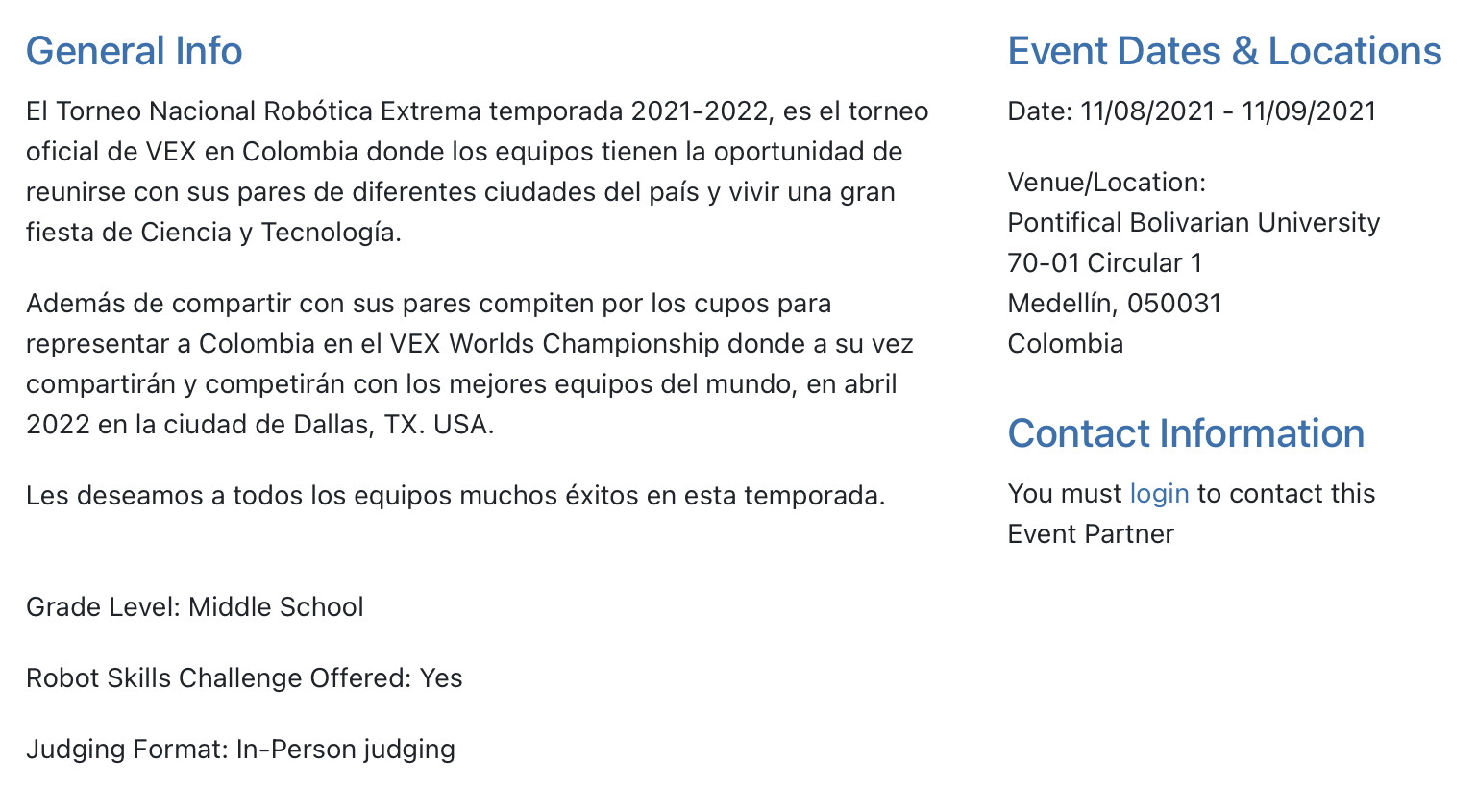

According to the event info, this event should qualify teams for the VEX World Championship.
(In addition to competing with their peers, they compete for places to represent Colombia in the VEX Worlds Championship where they will in turn share and compete with the best teams in the world, in April 2022 in the city of Dallas, TX. USA translation mine)

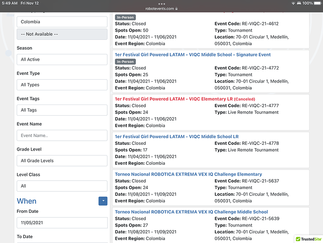

But then again, that isn’t reflected in the awards section. It also looks like it was the last event in Colombia (at least for what is posted to robotevents).
So this definitely is a peculiar case. If it does end up awarding qualification spots to the World Championship, there could be a slight chance that the team with the dumper bot doesn’t know it is illegal (according to the rules as we know them right now), and cannot compete with their amazing strategy. But if it doesn’t, and another event that will be posted in the future does, there will still be a chance that they can be made aware of the rules and create a more legal robot (or at least play the matches by the rules and only dump 2 balls at a time).

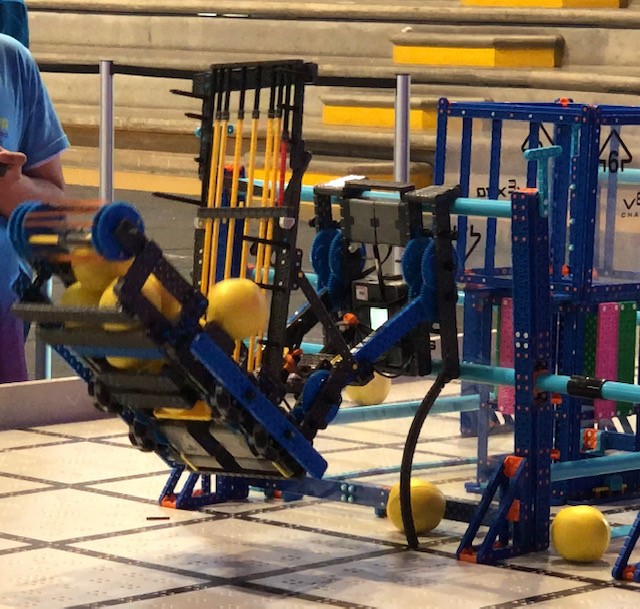

This robot at the moment of hanging drops a small chain to touch the floor.
For this reason it passes the rule “ Ball control is limited while Hanging. Robots which are not contacting the Floor may control a maximum of two (2) Balls.”
but I believe it already violates the rule " Expansion is limited during a Match."
![img_1|521x500]
From this image, it’s clearly violating the 19" height rule, and probably the 19" length rule as well.
