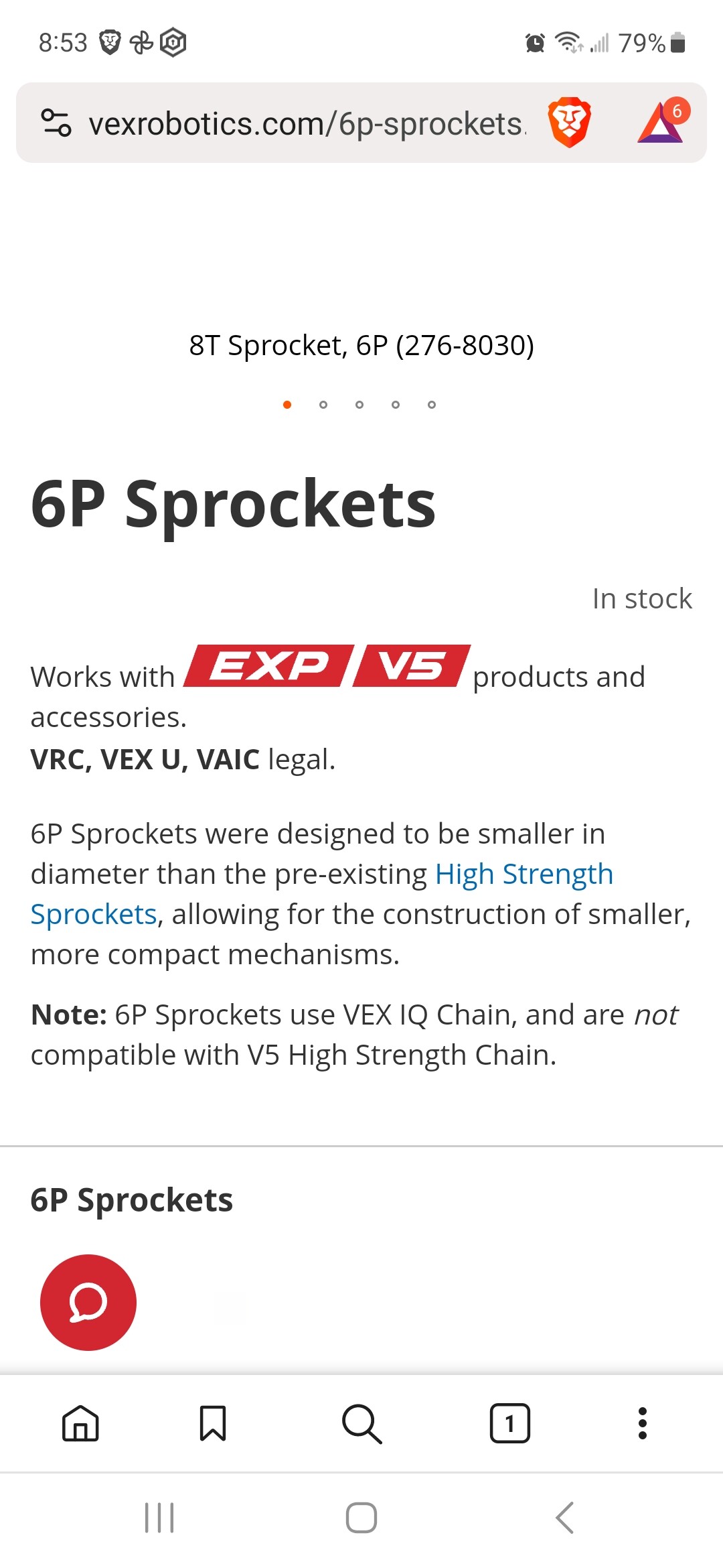

I was a little confused about the chain in general. I think I got it now but if I’m still off just let me know!
Seems like the 3p chain is discontinued. Probably to be replaced by the 6p as it’s the same as IQ, less stuff to stock.
The 6p chain is the same for IQ and VRC, but the sprockets are different. The 6p chain can be used on both, but the 6p tread is only for iq.
The 9p chain is the “high strength” version and is only for VRC. If you want to use tread on your VRC bot, 9p is your only option.
Does that all sound correct?

I think flaps are absolutely an intake to consider especially if you are using side rollers. Because there are so many ways to manipulate triballs, it is in your best interest to try out the ones you think seem good! And yes, vexU people can use any parts legal in IQ or VRC.
