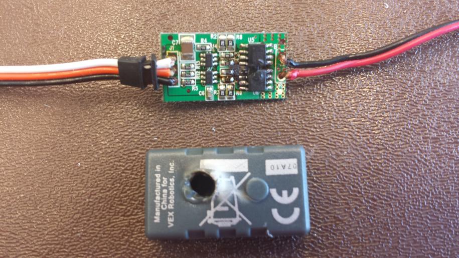

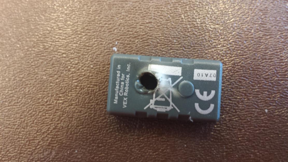

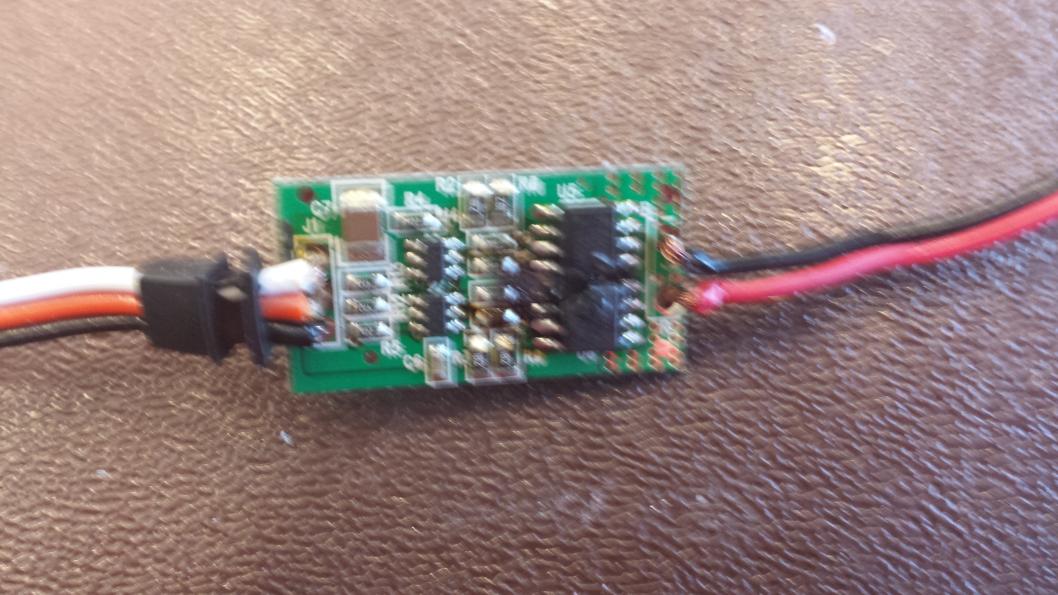

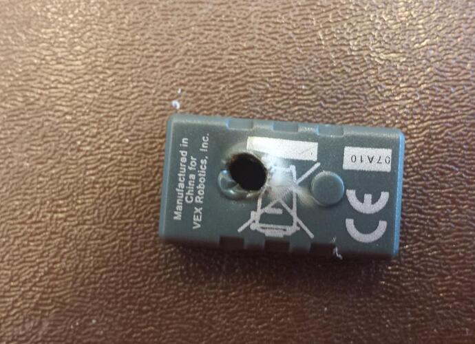

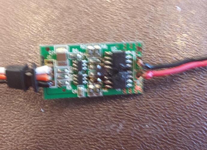

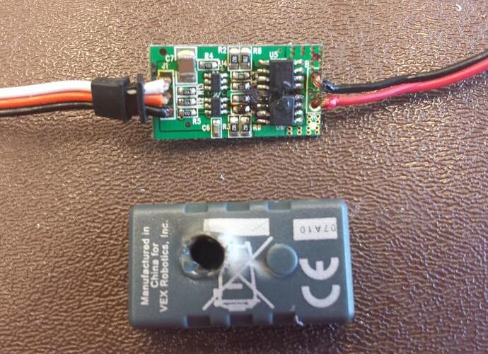

So as I was driving my prototype vex robot and the motor controller kind of blew up and burned a hole through it, It started to spark and I just sat the robot down and turned it off. I’ve tried the same motor with different controllers and the motor controller would over head and stop working. Everything else works great, all four motors including the one the motor controller is plugged into. I’ve also split the motors in the Vexnet (1,10 and 2,9). Can anybody tell me why this happened?

You probably shorted the output of the motor controller. This has happened before, although not that often. Check for any exposed wire or pinched wires on the motor. Check that the wire strain relief on the motor has not been damaged.

Come to find out, the black and red wires were touching. We’ve split the wires and tapped them.
