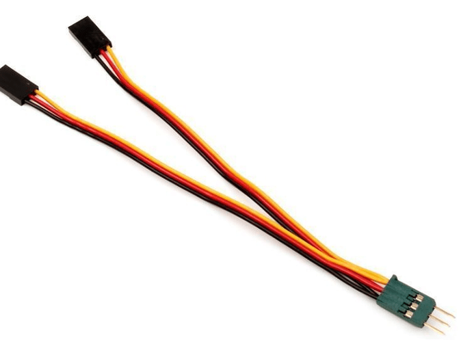

For In The Zone, the manual states that we can use 12 motors. However, there are only 10 motor slots. In which other slots can you put 393 Motors? (first time for VRC)
Tegicupala,

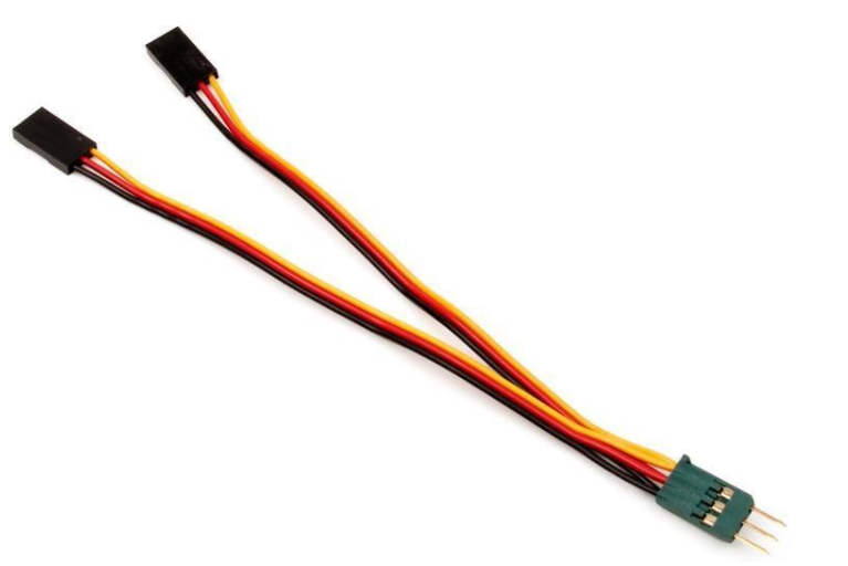

In order to connect the two extra motors you will have to use a 3-Wire Y Cable, you can find it in our website under SKU# 276-1423
Picture attached.
