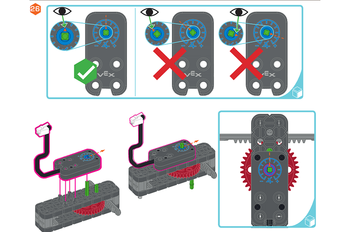

So we set up the off-road truck today. It goes forward and backwards no problem but will not steer left and right.
The front motor works, when we try to play with setups the front wheels will jitter left and right, but nothing more.

This is a common problem with this kit.
  1. Verify that the turn sensor on the front is positioned correctly. When the truck starts up, the front wheels will turn left then right then back to center.
  2. Do you have the latest version of the software? The hexbug software needs to be on the latest version.
If you do the above things then you should call VEX/Hexbug support during working hours.

Is there any way to see if it’s ok without having to undo the whole truck?

Sadly, that sensor is DEEP inside the engine area. You don’t need to take apart the entire truck but you will need to take the front apart. As I remember, taking the hood off and going that way was slightly easier than taking the bottom off.
In either direction you are looking at about 1/2 hour of disassembly/assembly time. I would take it apart, verify the the placement and then try it outside of the truck. That way if they decide you need a new sensor that you are not taking it apart AGAIN.

Just to tack on to this, this is referring to step 26.
The orange arrow on the sensor should be pointing at 12 o’clock as it is assembled.

I have an issue with the steering too (originally thought problem was lack of power (https://www.vexforum.com/t/vex-offroad-truck-underpowered-struggling-to-move/89729/4). Turn sensor is correctly positioned, but after connecting to app steering goes left, right, but then fails to centre, going hard to one side:
