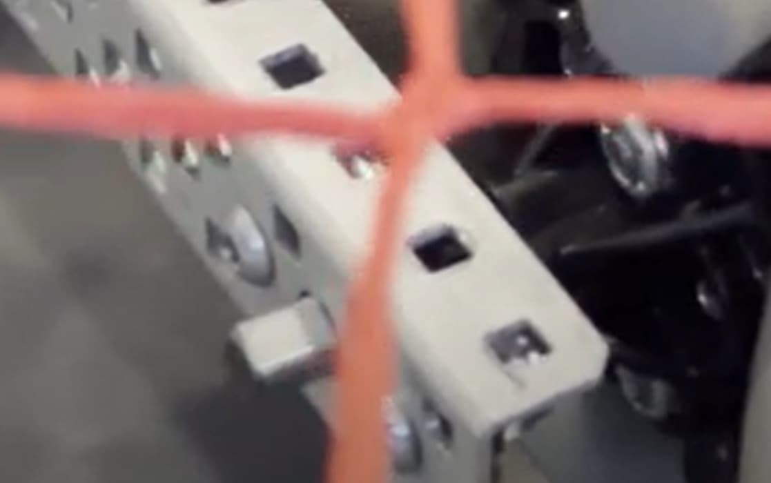

I love it! It’s very interesting to see what you guys came up with, especially within 3 days!
The VEXPro mechanum wheels let us easily use HS axles and require less adapters to use LS axles. We also didn’t like the idea of using LS axles for such a wide drive spacing.
Is there a gear ratio for the chassis?
I noticed you sometimes had trouble just pushing the triballs over, so I would recommend adding a slight wedge to push them up and over quickly.
