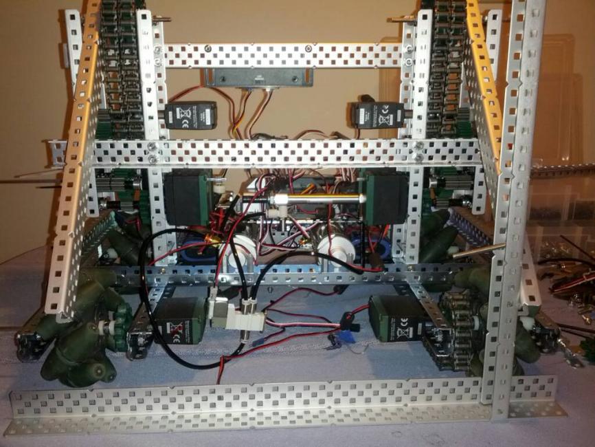

http://sphotos-a.xx.fbcdn.net/hphotos-ash3/526404_243881622399094_74686599_n.jpg
You can use spacers like this picture of my robot. Or you could make a lever. The lever would also increase your force but takes up more space. So depending on what you wanted to use them for…

From experience my piston is still fully functional after going to 2 competitions and Worlds with that transmission of mine. So no it does not damage it. Or shouldn’t anyways.

The piston should still push with full power, and I don’t think it should harm anything. The threads on the tip should hold fine against the pounding of the spacers when you retract.
Also, limiting distance of the piston doesn’t dramatically decrease the amount of air each actuation consumes, because the solenoid still opens and equalizes the pressure on both sides.
