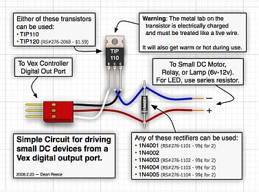

I have successfully used 5v relays (coils driven with 5v) with the controller. If you know how to use any generic transistor such as 2N2222 to turn on a relay, this will be easy. Google for some circuits.

Of course, this diagram may not fit your use. Alter where required e.g. switch used to turn on external circuit which does not have common ground.
I have the design for the circuit, Quazar made it.
It uses a diode and a transistor with two output wires. Its a very simple circuit but I would much rather have a relay board so that you would have plug an play. Making it yourself works but I would prefer vex to make it. And you can only draw 5v at 30ma which is not enough to power a large relay directly.

An Opto-isolator can be used to seperate the Vex’s Electrical Systems from the Transistor and Relay.
Check out the Relay Boards that I built for my EarthBot aka GardenBot robot. I described the construction of GardenBot for an article that I wrote for Nuts & Volts Magazine, which was published in 2001. It is remotely controlled and can carry payloads of 185 pounds or more.

What did you use to draw that? I’ve got a couple circuits that I’d like to put into a format like that.
I used OmniGraffle Pro, which is just a basic drawing and page layout program. It isn’t a schematic capture or real drafting program.

Some reasons why we dont use a TIP110/120 to drive a relay: its overrated. A relay typically draws 30-100ma (max?). A generic transistor (and cheaper) BC3__ or 2N____ series will suffice. If not enough current from the 5v supply, tap directly from the battery or throw in an extra LM7805.
One cool thing about the small relays is that you can use a DIP socket to hold it instead of soldering it directly to the PCB. I made one with stripboard, a drill and a soldering iron, a spare LM7805 (TO220 package with tab soldered to the board to drain any heat)
