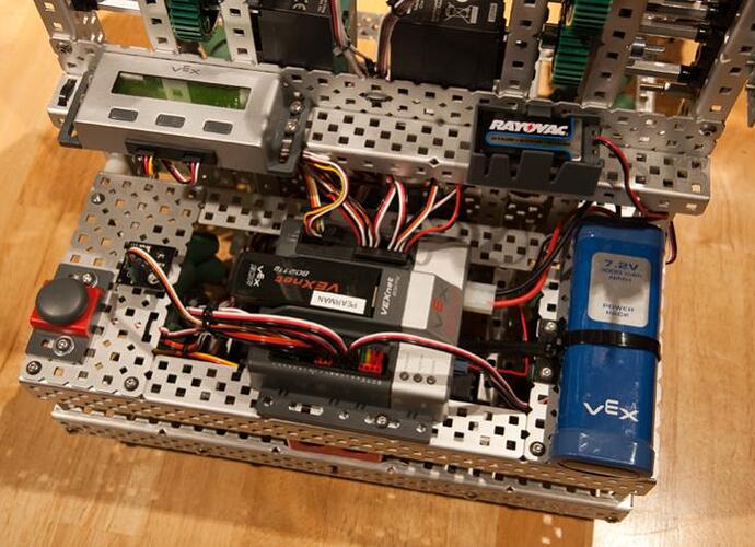

  4. the wiring has to be clean. if you can see wire its not clean enough.

  • Protect all pwm prongs

  • Tape up electronics

  • Combine electronics into a single sheath when possible

Don’t bury the cortex inside the robot where the field techs cannot see it.
Allow access to the cortex power switch.
Keep the VEXnet key free of structure to improve WiFi reception.
Keep the wiring clean and organized.
Use a backup battery.
Use the wire securing plastic clips on the cortex.
Here is an example.
[ATTACH]7134[/ATTACH]
