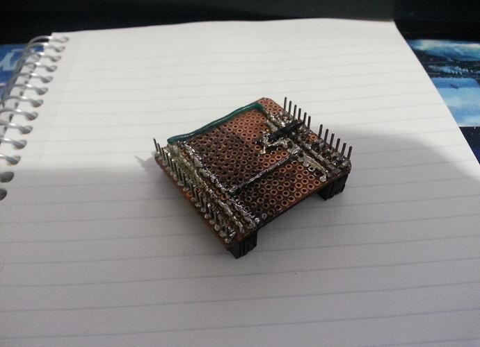

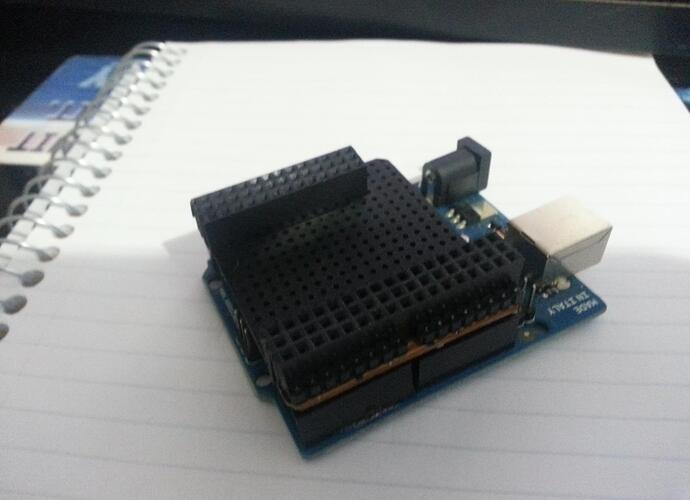

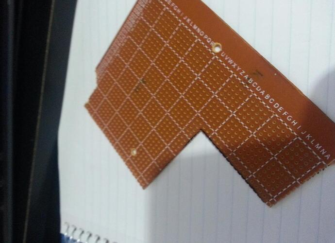

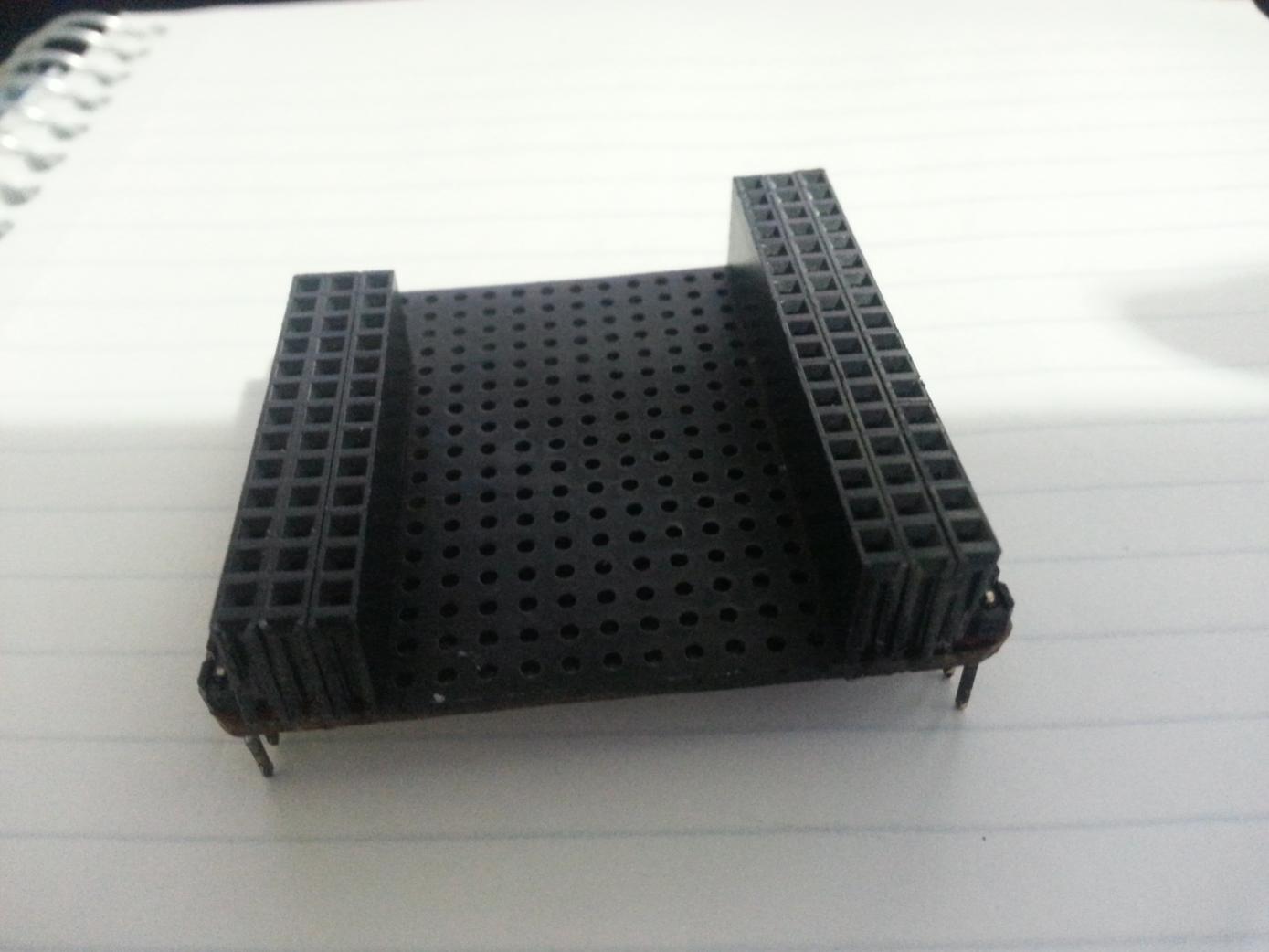

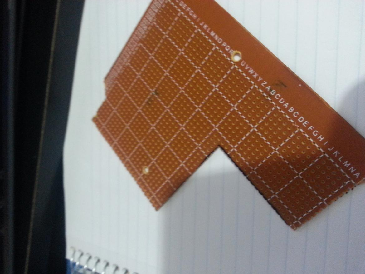

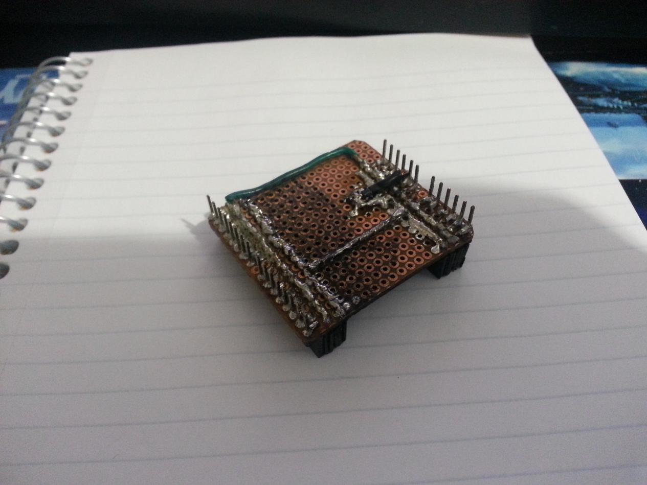

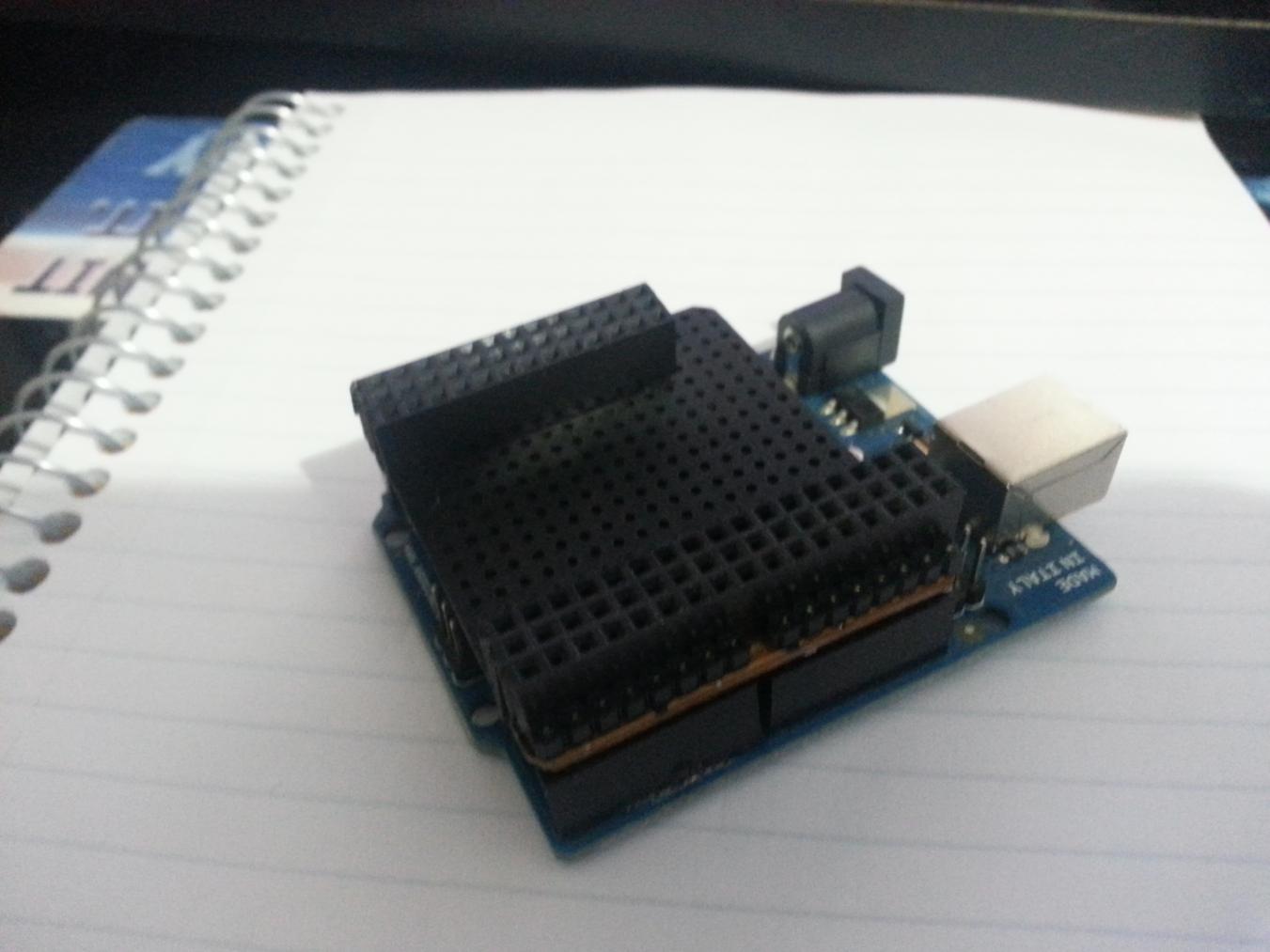

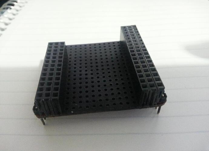

I built my own custom shield. Its main purpose was just to be used as a sensor shield. The simplest way i made the switches work with the Arduino was to just open them and solder the red wire.
P.s. Solder job was a little messy, but shield works great!
Thank you for all the very useful replies. So it sounds like the software controlled Pullup resistor is a go. That was my main concern. I will upload the board files and result when i get them done.
