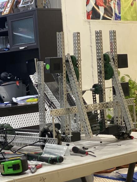

Hello everyone, I am having an issue with one of the two lifts on my robot. The lift that does is suppose to lift up nuetral mobile goals does not seem to lift. I am using two motors - geared internally for torque and slightly geared externally for torque - and my lift cannot lift the mobile goal two inches off the ground. Additionally, the motors are programmed at like 800% power. With my Vex Competition this Saturday is there anyway that I could ressolve this issue quickly.

I can send some pictures of the lift, there not that good but my robot is at school so this is what I got atm

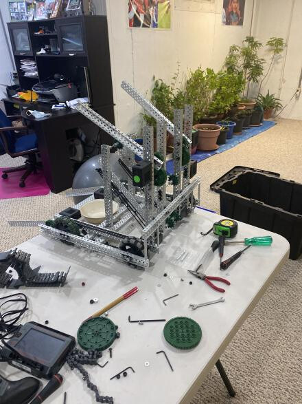

These are the two pictures I got I hope this might help, the robot is basically complete but the lift looks like this atm
What types of cartridges are in the Tower Motors?
They are red cartridges. The weird thing is I used the same gearing structure for my mobile goal lift and it can pick up mobile goals just fine, but for my normal lift it cannot lift a mobile goal at all.
Your lift is geared for speed, not torque. Try switching the 36 and 60 tooth gears, and if that’s still not enough, switch the 36 tooth gear to a 12 tooth gear.

  1. Are your motors direct driving your lift? - If yes, then this may be your problem you need a ratio geared for torque so maybe a 36 to 60, but the better option would be 12 to 60.
  2. If 1. is no then what gear ratio do you have? From your pictures it appears that there is a 60 or 72 tooth gear below a 36 tooth gear which would be a ratio for speed if the motor is connected to the larger gear. Which would also explain your problem because a ratio geared toward speed is not one made for lifting mogos.
