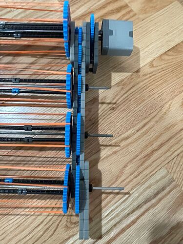

I have 4 rollers for full voume (gears attached with rubber bands) for intake,
I attached them with several gears along a 2x20 plate to the side.
I want to know why rollers are spinning in different directions.
Two rollers are spinning in direction and the other two in the opposite direction.
I want them all to spin in the same direction so it can intake the blocks properly
Anyone know what the problem is/how to solve it?
Will send pictures if necessary.

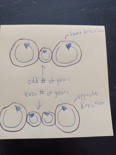

Adding on to @Penguin1 , here is a diagram of gears:
An even number of gears, including 0, between the 2 end gears will result in them spinning in opposite directions. Also as Penguin 1 said, use sprockets to link all 4 rollers together, as that guarantees that the rollers will spin in the same direction.

Thanks for the pic!

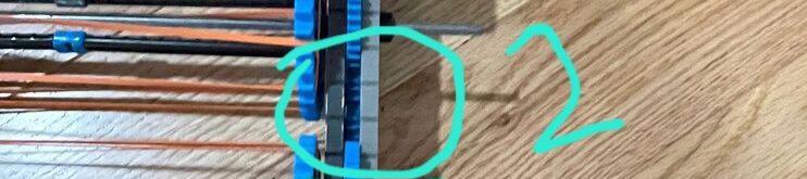

Here is the issue in the green circle. Those two gears reverse the direction of the bottom two rollers.
Use 1 gear or an odd number of gears instead
Alright, thank you! I was able to fix it and it’s turning in the right direction now.
