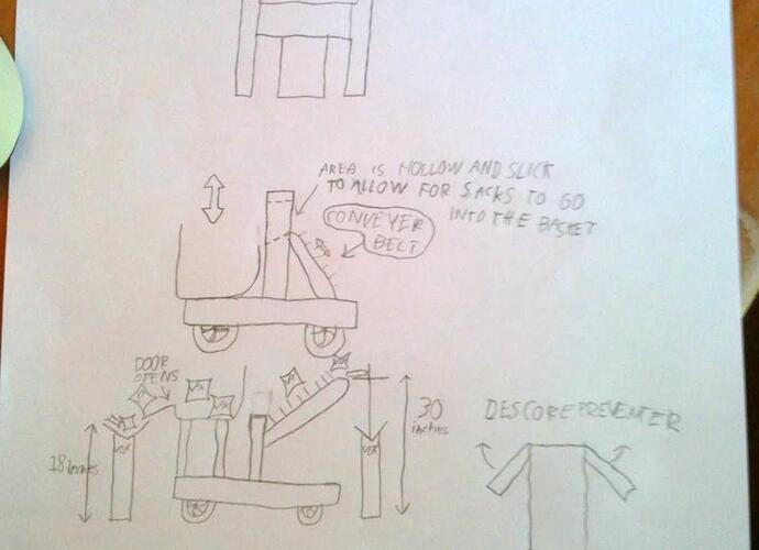

Here is a design I have for a robot, and I would like some feedback on if this is a good design or not.
http://ebaypictures.webs.com/photos/undefined/tgr%20robotics%20design%20small.jpg
About my design:
The front of the robot has a conveyer belt that will be able to go down, pick up sacks, and then raise up to either put the sacks in the 30 inch platform, or in the basket in the back of the robot which can raise up using linear slides and dump the sacks into a trough. Also, on the conveyer belt are two bars that can fold out and go over the trough to prevent other robots from scoring their sacks or descoring our sacks.
What we want our robot to do:
Overall, we want this robot to be able to score in all of the goals, block other robots from scoring their sacks, or descoring our sacks, as well as move quickly and powerfully.
How we plan on playing:
At the beginning of the driver control period we should go for the bonus sacks and put around 3 sacks (which is my estimated maximum for how many sacks can fit on the platform) on the 30 inch platform to get as many points for the platform as we can. We will then put a majority of our sacks in the 18 inch trough, and as a backup, we can score in the floor goals in case our robot’s arm breaks.
We were in an early Sack attack event, and we had a robot that was able to go under the troughs, but I don’t think that there is a big enough advantage to being able to go under the troughs because the only reason to go under is to descore the opponents floor goals, and we rarely see sacks scored in the floor goals due to the amount of points you get for scoring in floor goals vs the troughs.
Also, even though we could go under to score the sacks on their side, we don’t have that much time in the match, so we most likely won’t run out of sacks to score before our time is up. So I don’t see us really needing to go under the trough. If our opponents have a robot that can go under the trough to try and take our sacks, we will block them from descoring anything until they give up. We should use the full 18 inches of building space we have to make a robot that can go up to the 30 inch platform.

Have you tested this mechanism? I have found that just a conveyer belt by itself is insufficient to pick up the sacks. I’m not saying it’s impossible, just that I wasn’t able to do it.
Any particular reason for having 2 seperate lifting mechanisms? It seems like a huge waste of motors and space to me, where you could just make a single lift that could reach all the goals.
I assume you intend to do this pneumatically? Just remember rule <G11> when considering any kind of expansion to block something, as your robot could no longer be subject to protection from pinning etc. while expanded.
Whenever I see say someone say something like that I cringe :o. In Vex, power and speed tend to be opposites. The only way for a robot to move powerfully and quickly is to add more motors in the desired mechanism. Considering you are already looking at:
2 motors for intake
4 motors for lifts (2 for each)
You would have 4 leftover for the drive. I would say this is sufficient to make a relatively quick drive, but not a powerful one (in comparison to other robots).
There is more than one reason to go under the trough. Being able to go under the trough gives you access to almost twice as many game elements. This is useful not only in competitive matches, where you can potentially score more points, but also in matches against poor opponents, as it is easier to score higher SP. I would seriously reconsider about this, I think being able to go under the trough is a vital thing for a robot.
While this may be true at this stage of the season, it is likely that your and others’ robots will improve dramatically throughout the season, and the scoring rates will be much faster. I would design a robot that is ready for that eventuality now, instead of having to completely redesign later on.
Also, do you plan to be able to descore from the opponents trough? I identified this as a key feature of a robot very early in the season.

The picture for me isn’t working, so I can only go by the description. It sounds like you have two separate lifts, a trough lift, and a high-goal lift. You might want to consider (if you haven’t already) making them connected, so that they work as counter balances. So when the trough lift goes up, the high-goal lift goes down, and vice versa. If you don’t know what I mean, you could look up GER’s robot that did this in Round Up.
It’s interesting that you say that going under the troughs isn’t a big advantage, and you bring up valid points. However, I think you should try to think about further into the season when robots will be able to collect sacks much faster.

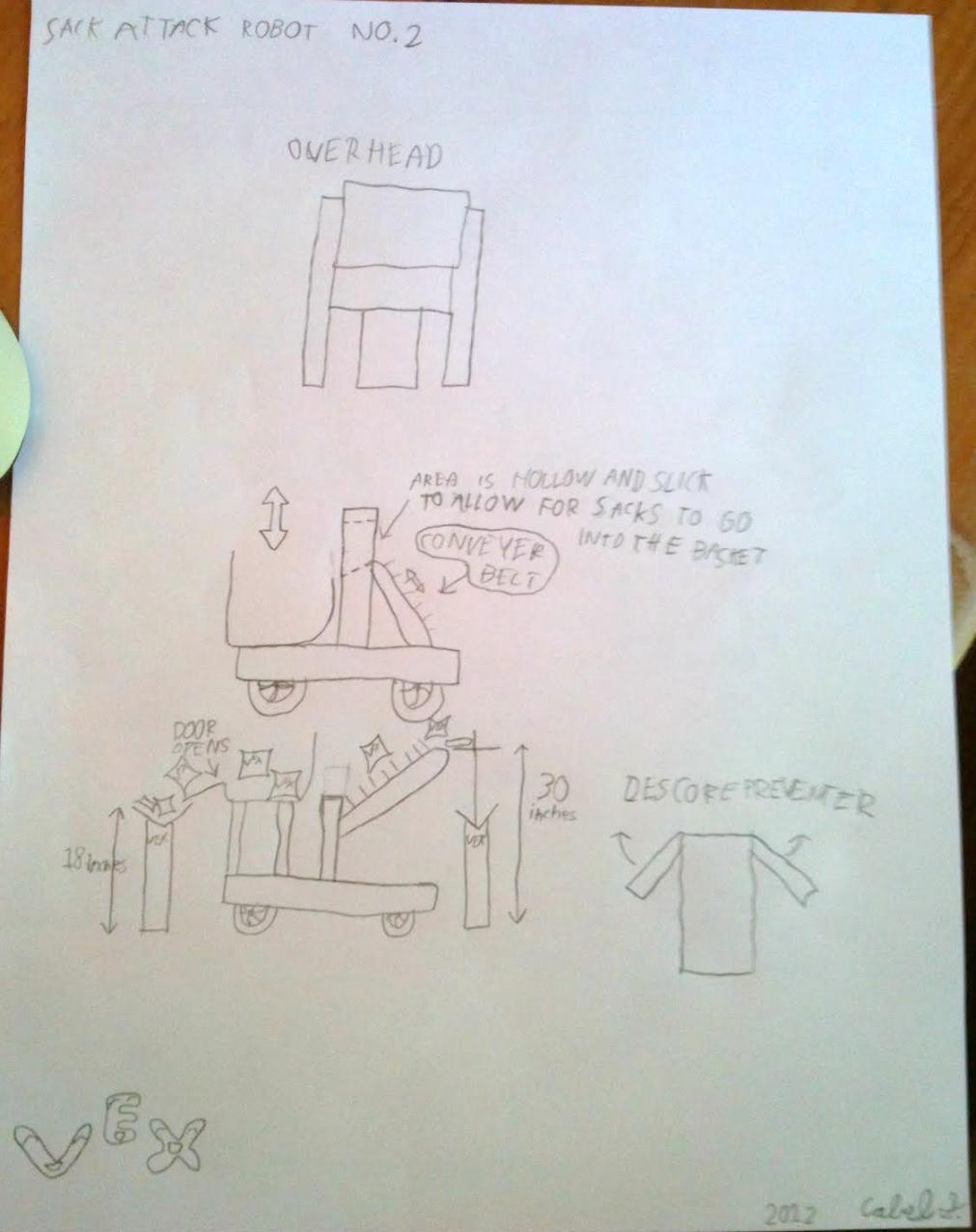

Hello everybody, I am Honmeg287’s team partner in team 2001. Thank you for all of your comments! We will be responding to them as soon as we discuss them together. In the mean time, here is the picture he was trying to post (it’s big so you can see the details):[ATTACH]6670[/ATTACH]
Thank you all very much for the feedback! My teammate Vacation9 and I are going to go over all of this again when we have our next meeting. I have changed the place web page where the photo is hosted, so it should work now. :smiley:

Do you have pneumatics available to use? To achieve your goal of a fast strong robot you are going to need to dedicate as many motors to your drive system as possible.
Do you plan of being able to open and close your basket, or is a a one time deal?
Where are your blocking flaps stored? I couldn’t tell from the drawing.
How does this conveyor work? Like Telemascope said, they seem difficult to make for the sacks and would be very interested in seeing what it looks like once you get it working.
Also, keep in mind that your basket will have to be inclined to let the sacks slide out. You will have to test different angles to find out what works with your basket material (since the coef. of friction is different for each)
I designed something similar to this back in May. The “conveyor” part is at a much lower angle to the ground then yours in the drawing, however, it can’t reach the high goal.
I really like how you guys started with what goals you want to accomplish and how to play before actually designing. It’s a common mistake a lot of people do and it ends up wasting time in the long run.
Overall, i think that is a good start. One of the best things about this robot is it’s powerful and massive(potentially) storage. Your idea of using a linear lift that’s well centered can lead to massive lifts as long as your gears/sprockets devices do not skip or bend. Your usage of rotational motion will also lead to very fast lifting speeds, which is necessary for scoring low amounts of sacks within the high goal. Also, the use of an elevated tank-drive over elevated holonomic drive with possibly 5 inch wheels, will give your robot high speeds, very powerful sideways traction(which is important for scoring large amounts of sacks at a time or capping goals), and less issues from sacks.

Another potential problem is the conveyor belt. From what i can tell, the robot acts similar to a scoop by shoveling up the pieces. From there the conveyor belt feeds to the intake. The main issue will be the actual shoveling portion. Since in your drawing you have fins, your belt wont exactly be flush with the ground, making it much harder to pick up sacks. to fix this, i recommend adding a large roller and chain together the conveyor belt.
as you know, motors only come in ether speed or torque. So, i recommend installing worm gear brakes on the robot. It allows you to remain at a decent speed, but it also locks up your wheels if another force tries turning your wheels.
I’m glad someone else is trying that mechanism. Currently the way it’s design( flips towards your opposing alliance) is a bit risky. I believe that it’s possible for another robot to push away the cap simply by driving into it. What i do is have the flaps flip open like wings. That way, if you make it sink into the troughs, it becomes extremely difficult to remove.
Anyways, with the proper modifications, it can be a challenging robot
The problem with that is, there are times when both the basket and the conveyor need to be down. Perhaps the motors could have a transmission that controls which mechanism they’re lifting.
