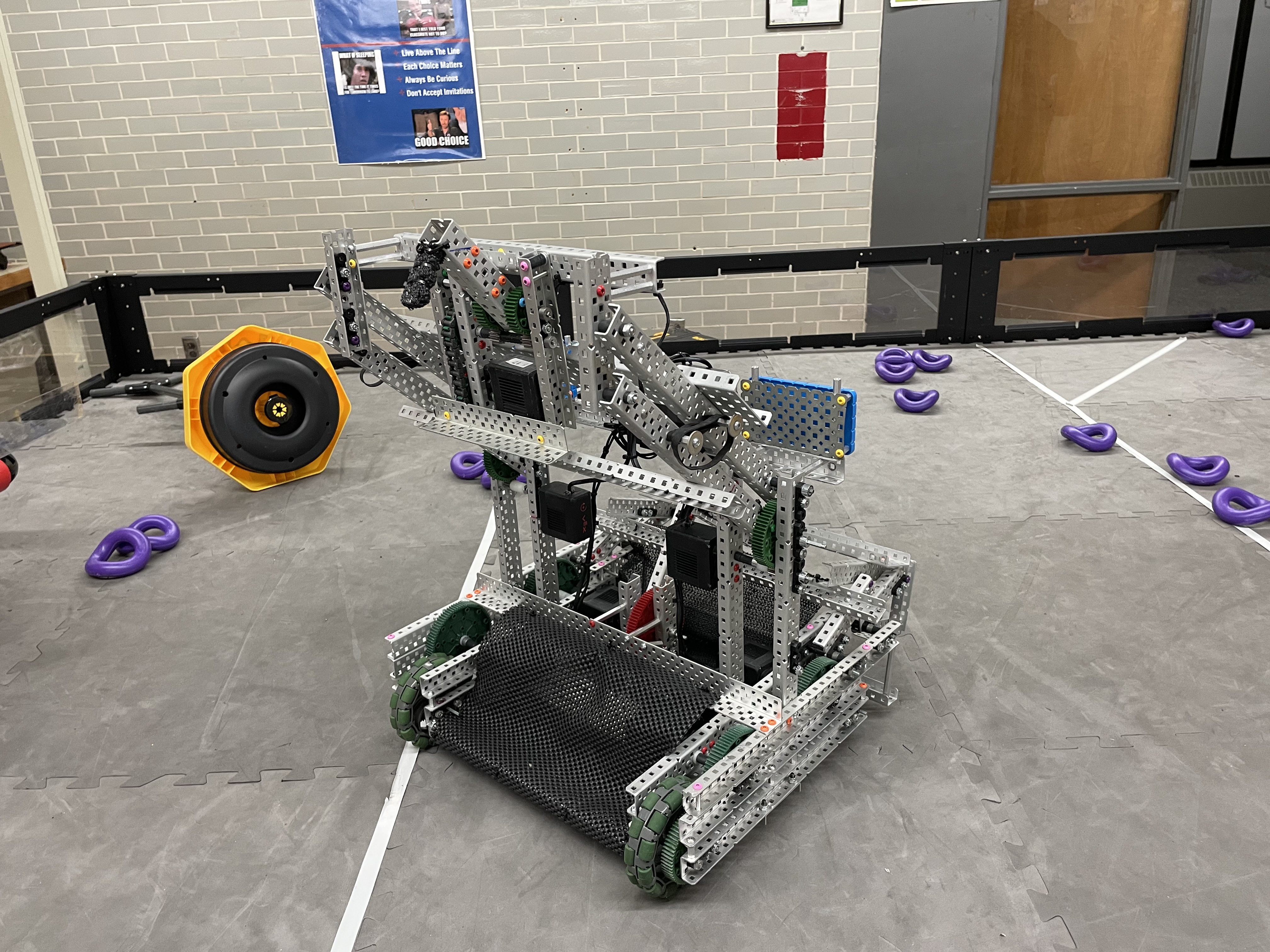

My Team has a robot that can pick up 2 goals, drive on platform, and place goals on platform.
We want to take our robot to the next level by adding sensors to make our autonomous and auto skills work better and be more consistent.
We have a variety of sensors but don’t really know what to use. What sensor types are your team using or other teams using? And how are you using them?
