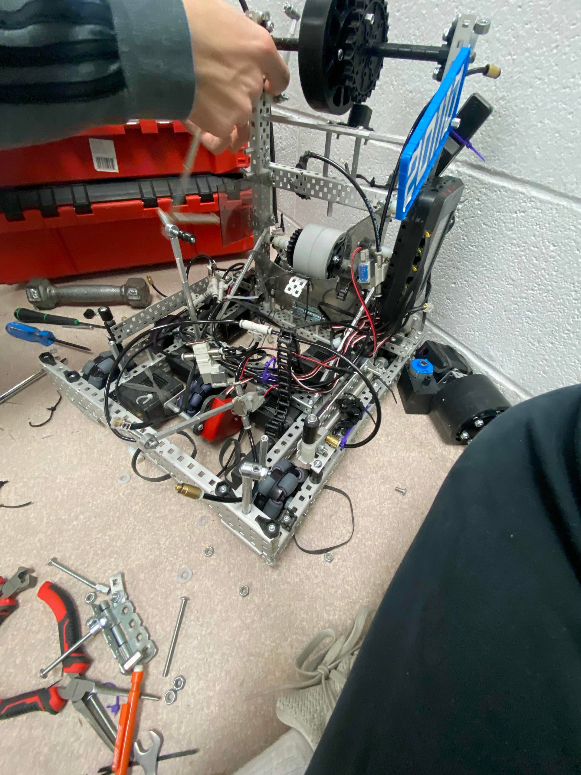

Thanks for the idea! I hope you don’t mind if we steal the IMU + two encoder Odom idea because our current three encoder Odom is really not accurate and I’m sure inertial can improve it
Do you use a ratchet for the indexer? Also, how does your expansion/string storage work? I’ve been trying out a bunch of designs but most of them are either not efficient with space or just weak in general.
Yes we use a ratchet for indexer. Our storage for engame is two 5-wide channels in the shape of a box. We wrap the string around standoffs and stuff it in the boxes. It works well enough.
What do you use for the actual firing mechanism? Thanks for the responses.
I assume you mean the indexer. It’s just two 1.625" flex wheels under the magazine. No tensioner, just gravity to feed the discs through.
I mean for the expansion, sorry about that.
What durometer of flex wheel are your indexer wheels?
It’s just a standoff attached to a piston. When the piston releases the standoff falls down and the projectile (some nuts on a ziptie) fires.
They are 45A.

Do you use a 60t gear for the ratchet?
Yes.
