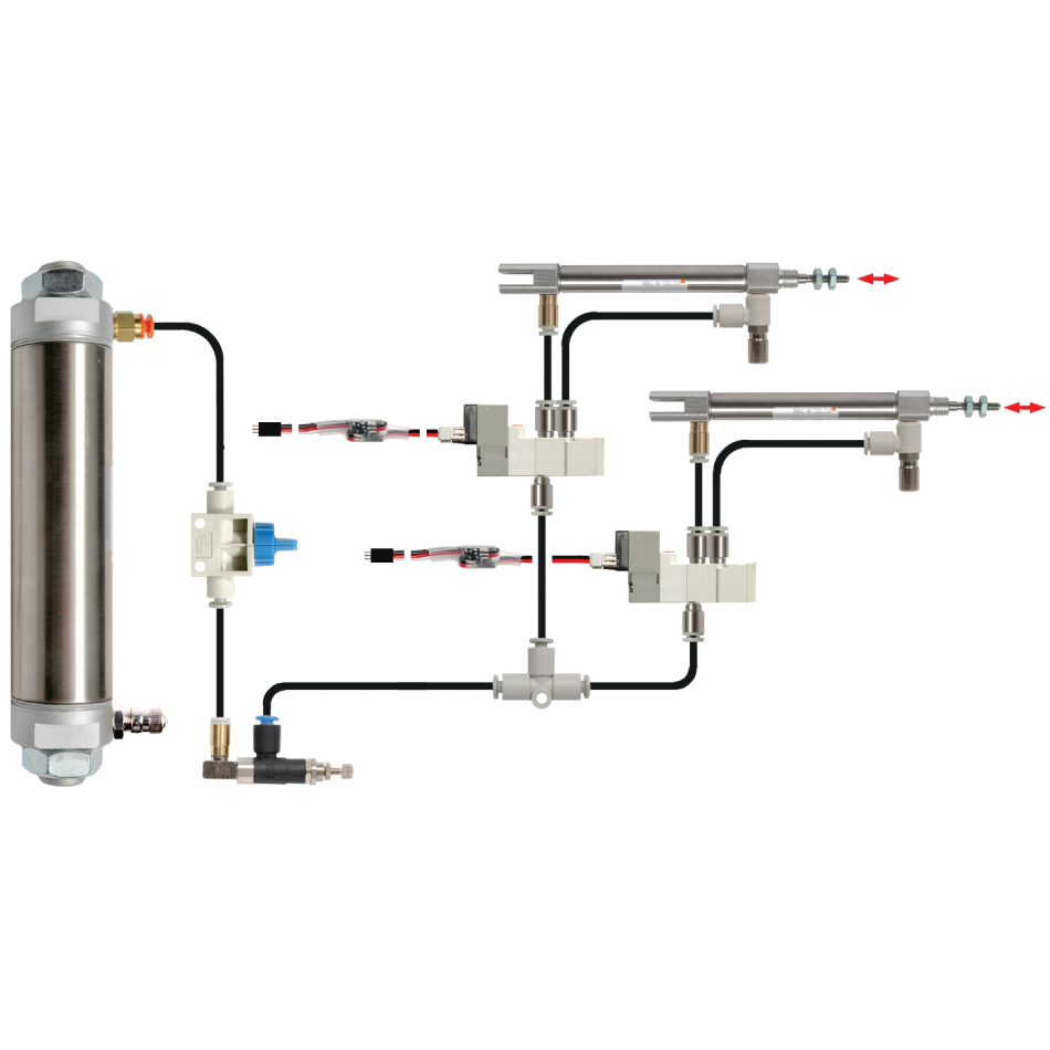

I have a question on how people are able to get a match out of this years game using a pneumatic claw. I am using 2 double acting cylinders similar to https://m.youtube.com/watch?v=yJKQKaWnA_ do u know how they are able to get so enough air for a match?? PLEASE HELP

Air consumption by the pneumatic cylinders is minimized by reducing the length between the solenoids and the cylinders, and regulating the working pressure to as low a level as will function. The distance between the reservior and the solenoids do not affect consumption.
If the design will allow, single acting cylinders use about half the air per complete cycle as do double acting cylinders; however, you are forced to deal with the internal spring (thus requiring more pressure). Using a double acting cylinder in a single-acting application (leaving the return port open to the atmosphere and plugging the extra solenoid port) reduces this problem.

45 actuactions is moee than enough to get you through a game, so a pressure regulator isnt really needed, the pistons themselves should be as close to 90 degrees as possible as thats there MOST EFFICIENT. Spot. Solonoids shouls be placed as close to the piston, and minimize tube length from solonoid to piston, as you lose less air that way. Points, as far away as possible

  1. While slightly slower opening, single action pistons nearly double the number of successful actuations.
  2. Move the solenoid as close as possible to the piston as possible; excess pneumatic tubing after the solenoid simply takes up and uses air.
  3. Pressure regulators decrease the pressure allowed past the regulator, thereby limiting the air usage. Using a pressure regulator will save air and increase the number of possible actuations. (If you choose to use a double acting cylinder, I would definitely put a pressure regulator on the “opening” solenoid, as you don’t need max air pressure to simply open the claw, thereby saving air)

Do I need 2 solenoid for each tank??

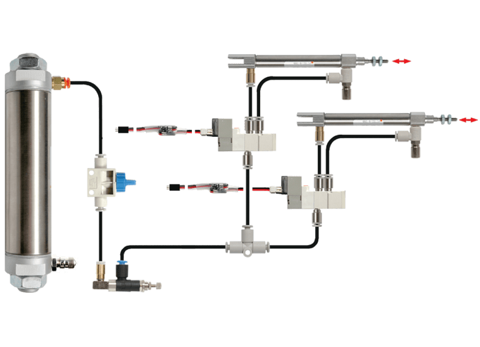

no you do not, you need an individual solenoid for each piston. Essentially, you are creating one very large circuit. In order to use two tanks, you can use a t fitting between them or just tube them together. After that, just create the exact hookup that vex has on their website photo of the pneumatic 2 kit with the dual acting cylinders and it should work just fine.
