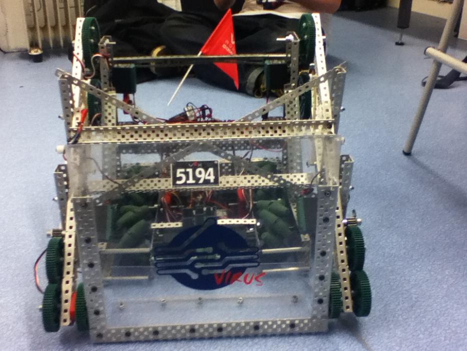

I like the simplicity of the lexan scoop. :slight_smile:

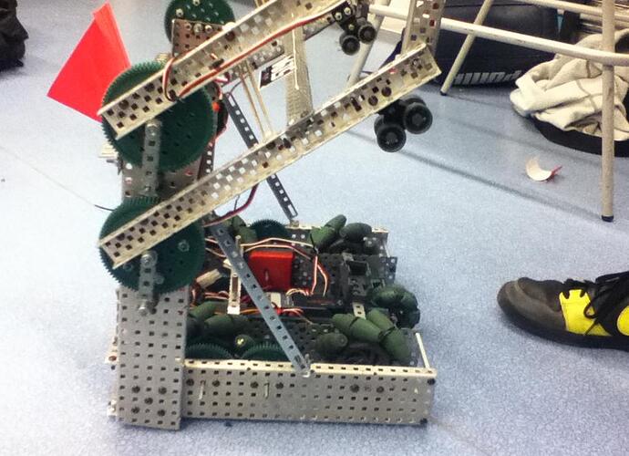

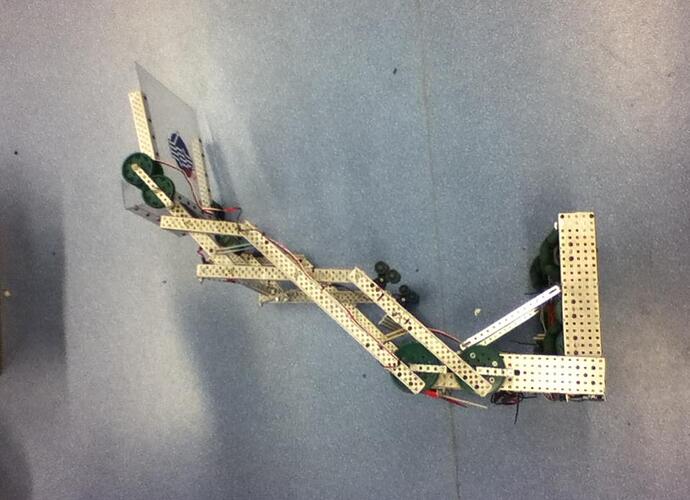

Now we are qualified for worlds, we are wondering if we need to change our robot. Can we have your guys honest opinions on whether or not our current robot will receive a thrashing?
Also, if we are going to do a re-build, is it worth buying pneumatics and if so which design.
Thanks a lot
It depends what your goals are.
Your current robot looks pretty good. Reliable score/descore, ect. Honestly it won’t win worlds though. I somewhat doubt it would be picked for the elimination matches, so if you really want to get that far I would recommend rebuilding.
However, if your goal is to meet some new people, have fun, and play some good matches, you would not necessarily need to rebuild. Your current robot is good enough that I would estimate you would win about half of your matches, more or less depending on your partners and opponents, which is by no means a “thrashing” at the World Championship.
Also realize that you do not have much time left. One month (not including travel) is a very short time to build, program, and practice with an entirely different robot. It may be more beneficial to get more practice in with the current one. Only rebuild if you have your heart set on getting into the elimination matches, and you are confident in your abilities and willing spend the spend the time to build a whole new robot.
Our team is a MS team but we were in a few tournaments that combined MS and HS this year and your style of robot (wrist-action scooper) dominated both those tournaments and at one of them set the WR for programming skills at the time (175).
I don’t think I would spend a lot of time on your overall design - but instead I would invest a lot of time in perfecting the programming and practicing the driving to make the bot as absolutely smooth and precise as possible. Make sure to perfect de-scoring as well and you can do well with that bot.
Getting selected for finals takes so many different variables - with the time you have left I would recommend to my team to invest all their time to perfecting the design they qualified with.
Whatever your choice good luck and hope to see you guys at World’s!
