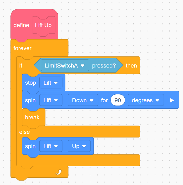

I can’t get my code to work. I want it to spin the lift until the limit switch is pressed and when the limit switch is pressed I want it to stop and move down 90 degrees.
Need to see the full code really. How is that MyBlock called? Is it in a loop?
Also which direction is up and which is down?
I know in IQ you can name directions in the config window.
It’s not in a loop. It’s called on its own in the autonomous section.
Forward is up and reverse is down
If the LiftUp function is called on a single line then it will check the status of the limit switch once and go on to the next step. If the limit switch is not pressed then it will tell the Lift motor to spin forward and it will keep going (unless there is another command that tells the Lift motor to do something else). It will not continue to check the status of the LimitSwitchA,
If you want the programming to continuously check the status of the switch then you need to put it inside of a while loop and most likely inside of its own Autonomous header.
If we could see the rest of your code we would have a better understanding to help you.

What you want should be done in a while or repeat until loop.
repeatUntil(limit switch pressed) {
  // This code will run over and over until, when the loop checks, the limit switch is pressed
  Lift.spin(up);
// This code will run after the condition (limit switch pressed) is true and the loop exits
Lift.spin(down 90 degrees);
This is all of the code that the Lift Up is using.
Try putting the if else block in Lift Up inside a forever loop and then adding a break block under the spin Lift forward for 90 degrees. This will keep running this part of the code until it reaches the break statement.

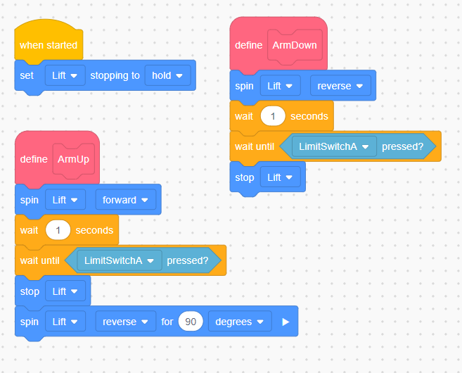

I have one limit switch and I want it to be able to raise and lower my lift until it is hit. I have the move down 90 degrees because after the switch is triggered, I need it to untriggered so I can then use it for the down movement. This probably sounds confusing so I can take a picture of my robot when I get home if you need.

I watched the video and I have two thoughts.
  1. My practical side wonders why you don’t use the built in motor encoders to tell the lift to go to a specific position.
  2. My creative side appreciates that you want to incorporate a limit switch with dual purposes and so I threw together the following code as something you can test. It involves two functions - one for each direction.
