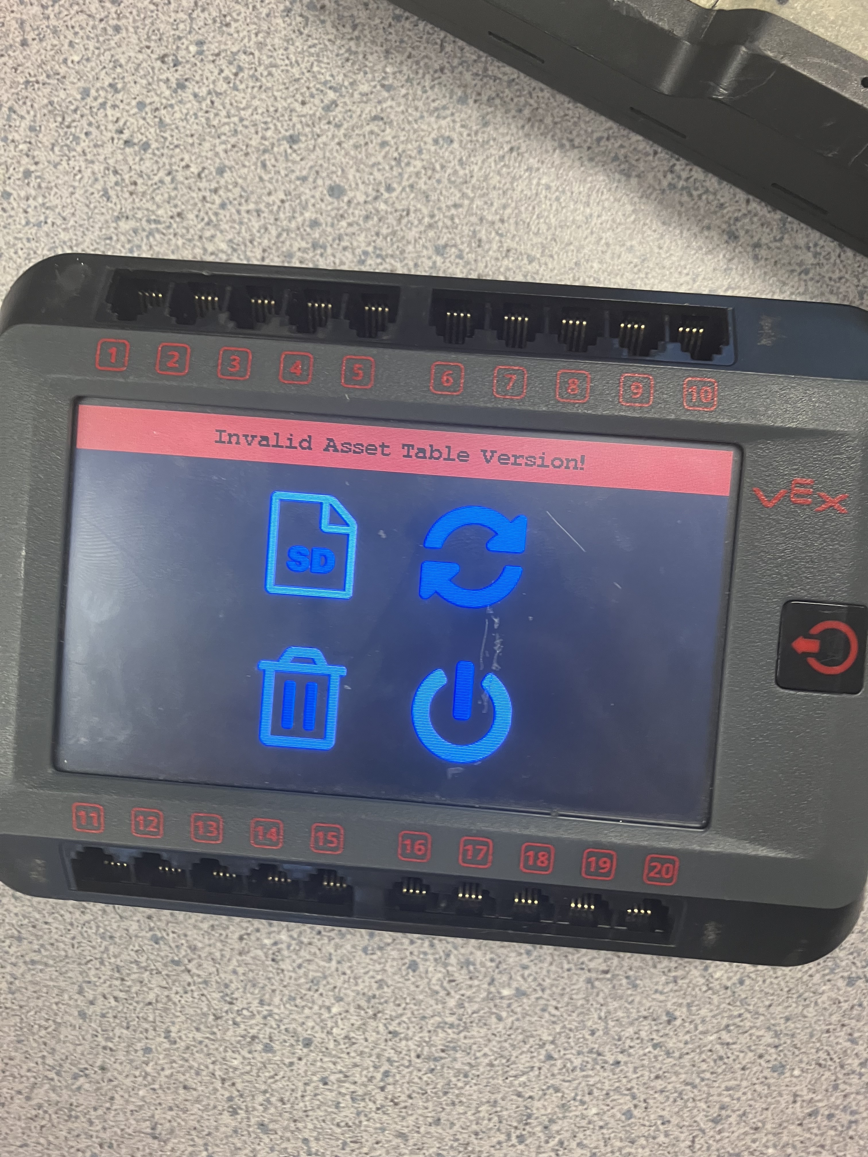

Vex V5 brain invalid asset table version
I am having a problem with a vex v5 brain where is shows a screen that says invalid asset table version. I don’t know how to solve this problem.
connect to PC using USB cable, reload the V5 firmware using VEXcode.
