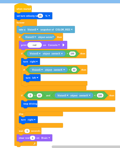

whenever I add a block that deals with the vision sensor item center it gives TypeError: indices must be integers
Could you post your code? it is much easier to help if we can see what your code looks like.
here is the code I’m trying to get it to follow a red ball
Try using a block that says “set vision5 object item to” and put 1. Put it inside the forever loop.
Sorry for the late response and I tried adding the set object to 1 and it worked
