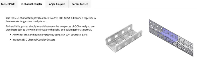

actually, the c-channel couple is more narrow and slips inside:
