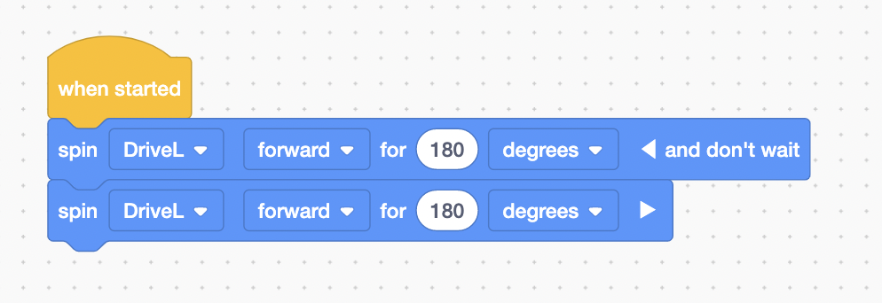

One downside of the drivetrain object in VEXcode blocks is that if you use the drivetrain object, you lose the ability to address the drive motors individually. If you instead want to configure the motors individually you could do something like this:
