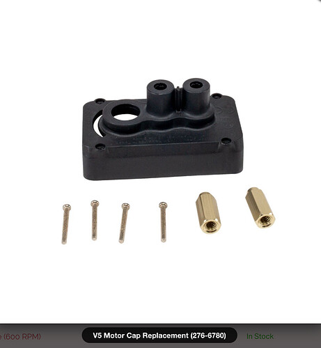

Vex V5 Motor Faceplate
I find that I Manage to be stripping the faceplate screw hole when I put the vex standard screws is there a replacement or a solution
Is this what you want:
https://www.robosource.net/home/359-v5-motor-housing-screws.html
No I am taking about the screw port on the motor which your use to screw on the robot the metal in those seems to be bending to a point where screws are unusable
You can replace them with standoffs.
vex sells replacements for those actually.
V5 Smart Motor Cap Replacement might be what you want.
It’s the entire top plate of the motor.
You want part 276-6781. They are similar to 1/2" standoffs, but have a projected lip on one end to align the motor with vex structural holes.
