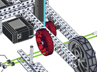

So, are you using the gear ratios in the Moby design? Motors tend to heat up when they draw too much power and a proper gear ratio helps reduce the draw. You will also see other teams using rubber bands to pull up on arms to counter the weight of the goals.

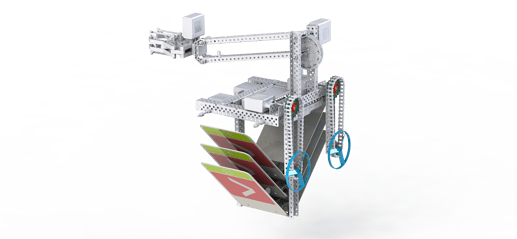

Here’s the preview of the VEX build from the Future Game Development Group: Water game development video
As Hudson_Robotics said, make sure you are using gear ratios. For our lift we have and 12:84 ratio, or 1:8. Also, try to get torque cartridges for the motors if you coach can get them. They are red in color and go inside the motor.
