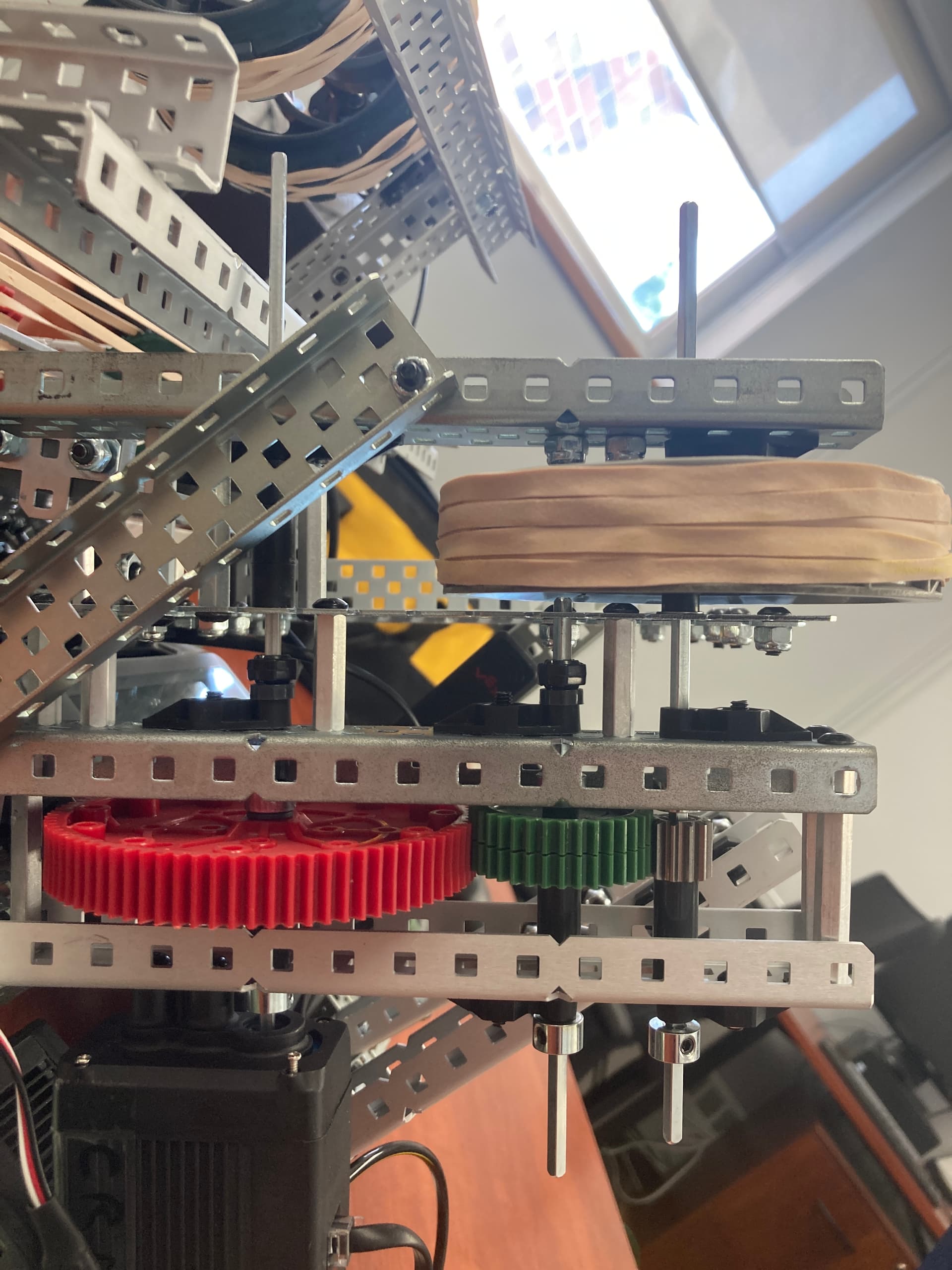

During our season, our team has been coming across a small problem: we have been using a 600 rpm cartridge for our flywheel and after about 40 seconds of running, the speed dies down and eventually comes to a stop and can’t move on its own anymore… we even tried switching motors, gear cartridges, etc. and the problem still persists. I cant tell if its a burn out or a dead motor, but any advice would be helpful since our competition is like two weeks away.

From what we tested yesterday, the motor was able to run again after a few mins of sitting but it didnt feel like they weren’t fully recovered. We are going to try again later today. I’ll upload a picture along with it too.
it looks like the motor did make somewhat of a recovery after cooling down overnight. we were able to run it for a full 2:40 until it stopped. the motor was hot and so were the axles. attached is an image of the flywheel setup
I see:
  1. blue motor cartridge
  2. ‘short’ bearings, the ones supported by only 1 screw
  3. motor shaft that’s way too long
  4. way overgeared
  5. green idler gear adds friction
The ‘short’ or one-sided bearings tend to kick up. Bearings, where at all possible, should be placed where the shaft is in the center hole with equal pressure from screws on each side keeps it nice a flat.
Shafts should be as short as possible. In a high speed mechanism like this, short shafts decrease the chance you will have a vibration from balance issues.
Go to the brain/coding. Get the data. This is a great opportunity for a notebook entry.
Problem: slowing down
Suspicion: too hot
Steps: coded brain to display watts/temps
Confirmed too hot
Resolution…
Remeasure data
conclusion…
We took your advice.
After changing the bearings to the 3 hole ones instead of just the 1, removing the green idling gear, and shortening the motor shaft the flywheel ran perfectly. Thank you everyone for all of your support. We really appreciate it.
