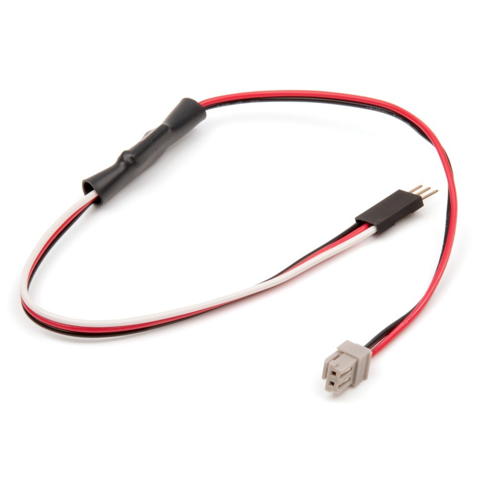

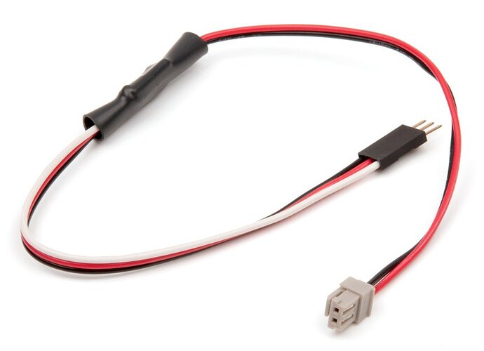

I feel like I’m missing some part or some wire, how do you plug in a two wire digital input from a pneumatic switch into the vex V5 brain. I genuinely feel confused.
You use a solenoid driver cable:
The same is also true of the Cortex system.
We’re trying to use those cables, I assume they are digital out and should be defined as such?
I think that’s correct. I’ve never personally used pneumatics but IIRC that is how they worked with the cortex so it should function the same with V5.
Thanks for the help! We had a bad solenoid driver cable and the code wasn’t working, so that wasn’t helpful lol
