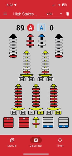

I found a bug in the high stakes score calculator in the VRC Hub app. The max score should be 88
88 checks out as the max score with the app however, if you
  1. Set the high stake to have no rings
  2. Increase a ring on another stack
  3. Give the high stake a ring
You end up with 89 points by having the same score but +1 for the extra ring on a stake. Afterwards by pressing the minus button on any of the non-high stakes it gets reset to 88 and you can’t press the plus button again to add it back. (The extra ring isn’t permanent).
Scoring app at proper max score:
Scoring app at improper max score (extra ring on alliance stake)
tl;dr Adding a ring to the high stake doesn’t check if the maximum number of rings has been reached.
