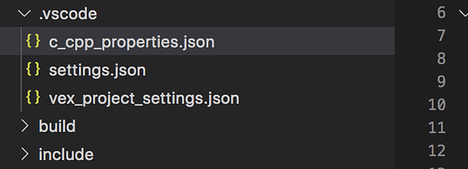

The build button will only be displayed if a valid VEX Extension project is detected.
A valid VEX Extension project includes a vex_project_settings.json file in the .vscode folder of your project directory.

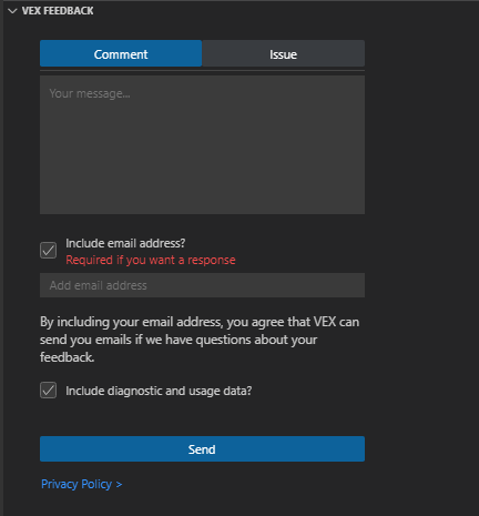

Could you submit an issue using the VEX Feedback Extension.
Then I can take a look at the logs and see what’s going on.
make sure you don’t have a .gitignore file that stops the .vscode folder from being commited. VEXcode V5 Pro may have created that entry as five years ago when we wrote V5 Pro it was thought to be a good idea.
I actually added a .vscode folder from the project since it is user specific settings that should only hold data that can be regenerated for different devs.
It is quite known practice (visual studio code - Should I commit the .vscode folder to source control? - Stack Overflow)
Does vscode extension for vex rely on .vscode folder to determine whether the project is valid or not?
The problem with .vscode is that it could also include OS-specific (mac vs windows) configuration as well which might not apply to other team members.
Could you confirm which file in .vscode the vex vscode extension use for the project validity check?
These files are all used as part of a VEX extension project.

pretty sure that c_cpp_properties.json and settings.json will be recreated or updated if they are removed or move between Mac/Windows. vex_project_settings.json does not have any OS specific information, you can probably just commit that one file.
