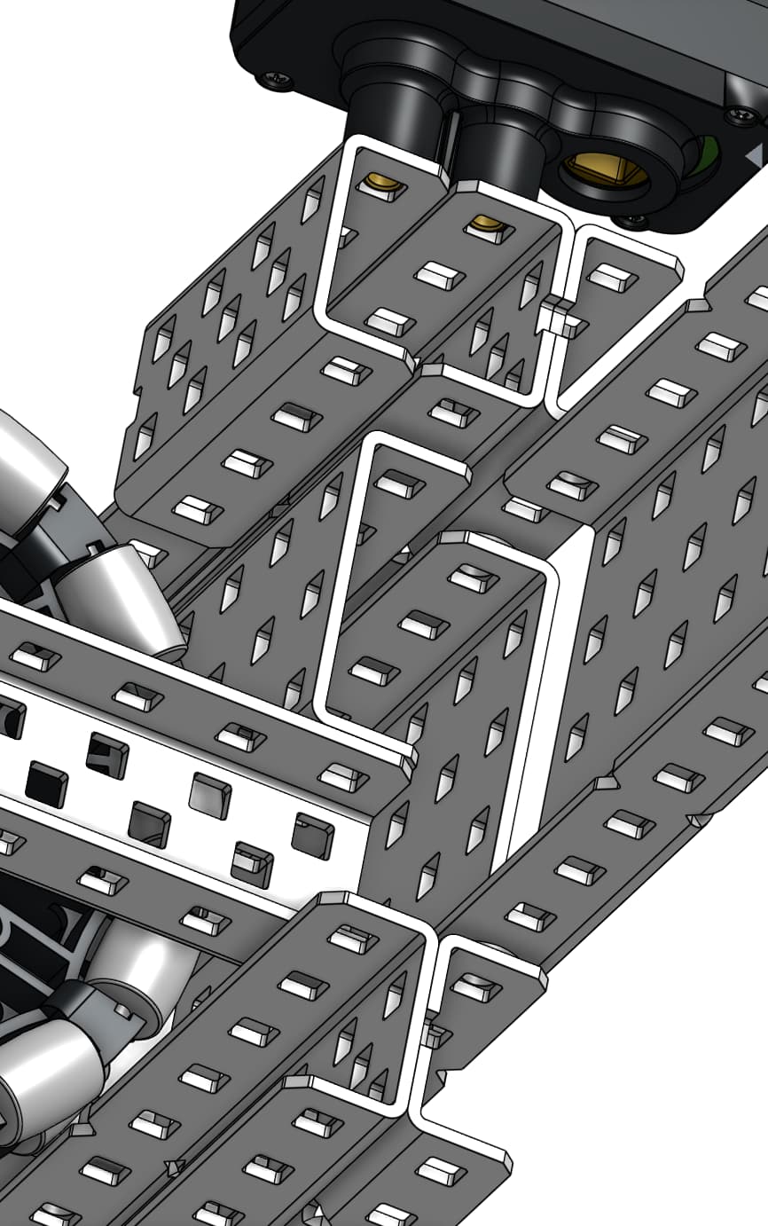

I have wings i am trying to make but i have no clue how i am going to rotate them with the axels do you know any pieces i can use sincerely JoBro.
Hi,
It looks like you are trying to spin the C-channel. You can try these lock bars: Drive Shaft Bar Lock (8-pack) - VEX Robotics or the plastic version and screw them onto the c-channel. The square hole in the middle is meant for axles.

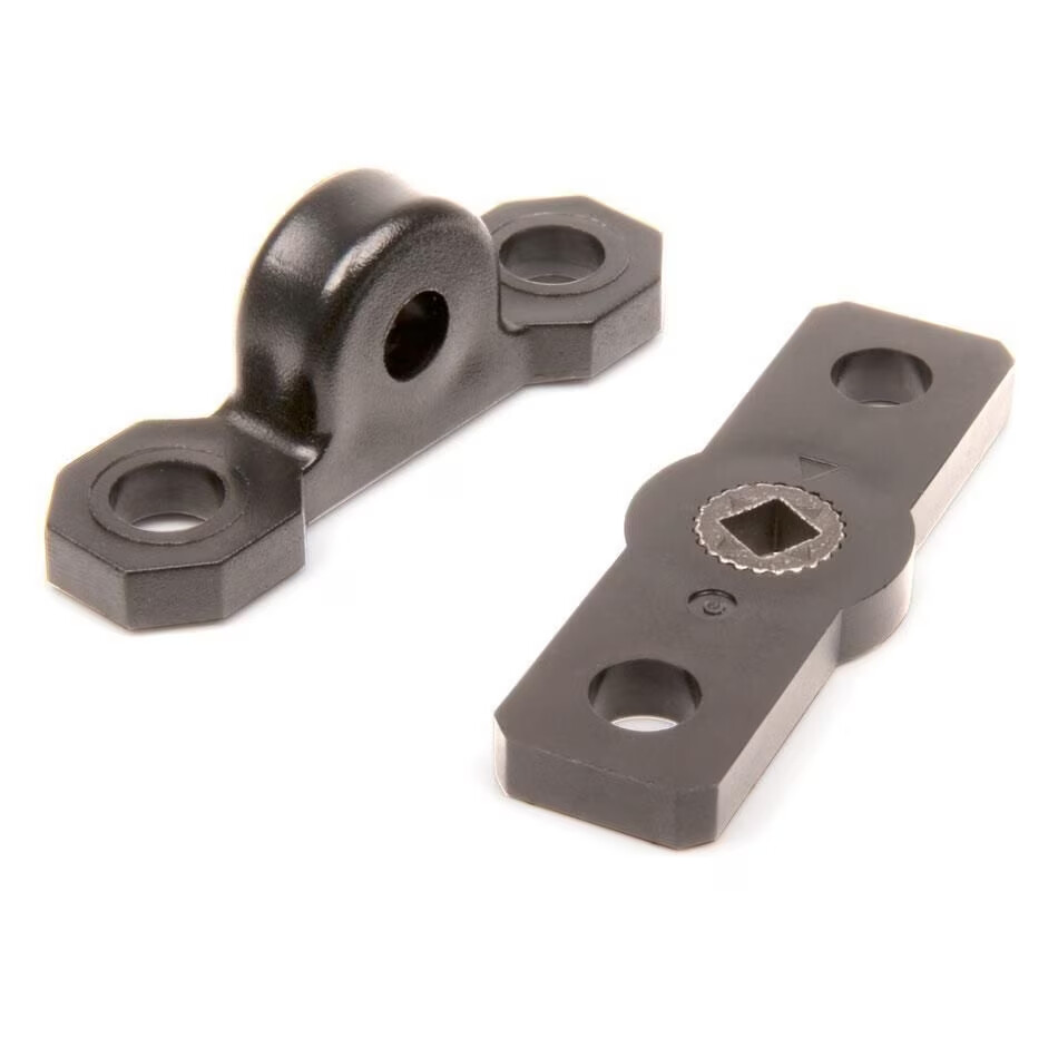

will these bearings work
The ones on the right should work.
only the one on the right will work. If you are trying to make wings I recommend that they fold from the topd down rather than the suide as they get pushed back easily
